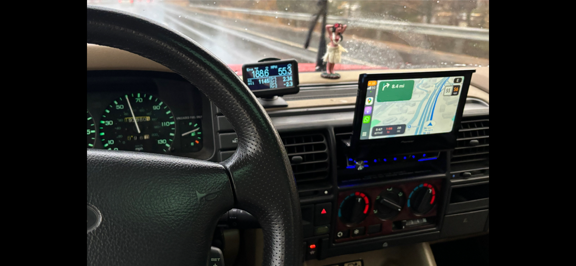

I’m trying to figure out if my speedometer is accurate. On the highway the speedometer says 70 mph, the Ultragauge says 64 mph, and my phone’s GPS says 66 mph. I’m surprised the speedometer and Ultragauge give different values because they’re both getting their info from the vehicle. I’m on standard 235/70R16 tires - exactly what’s in the manual.

Thanks for the comments. I timed highway markers for five miles and confirmed the speedometer is wrong and GPS and Ultragauge are correct. When the speedometer reads 60mph, the vehicle is actually at 55mph. For anyone else who notices a mismatch in their vehicle, your phone’s GPS likely has the correct value. I wonder how my Ultragauge is correctly getting speed data from the vehicle if the speedometer is wrong. I’ll look in the workshop manual to see if there’s a way to calibrate the speedometer. Thanks for the help!
