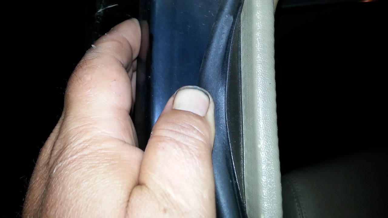

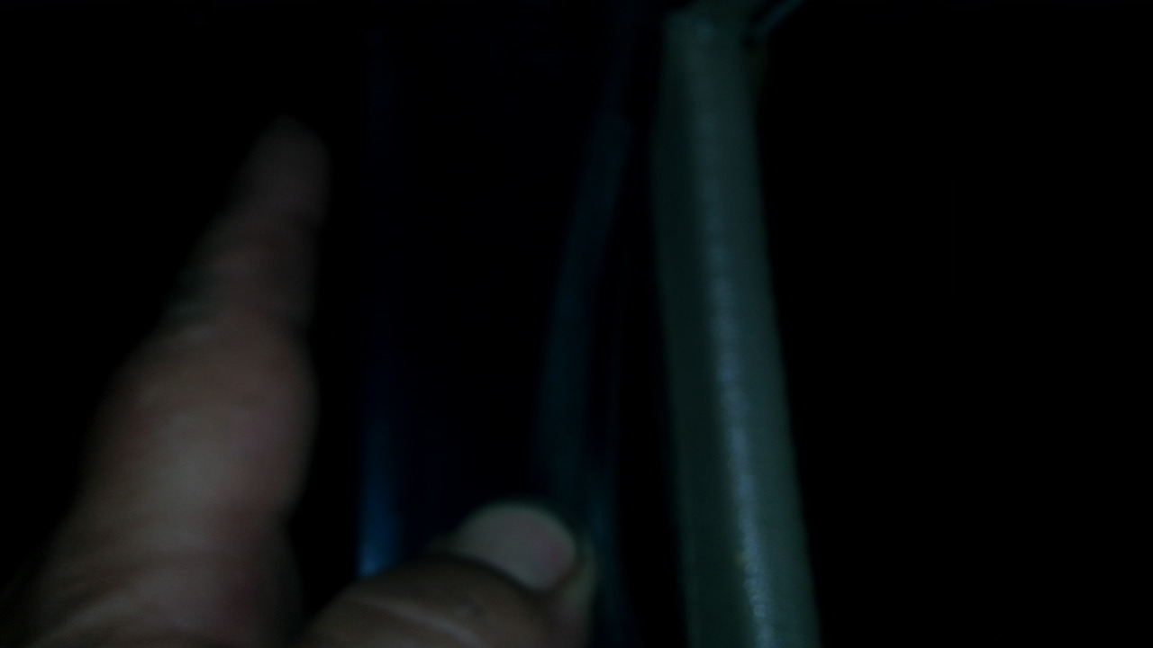

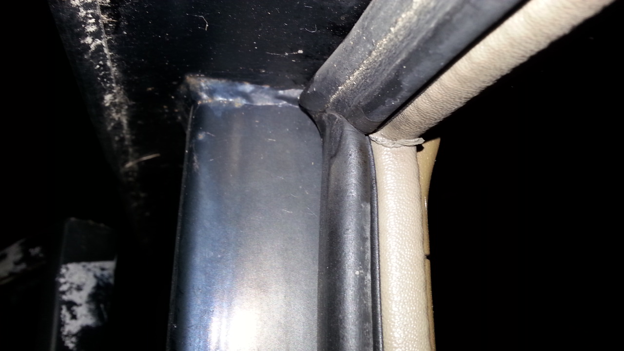

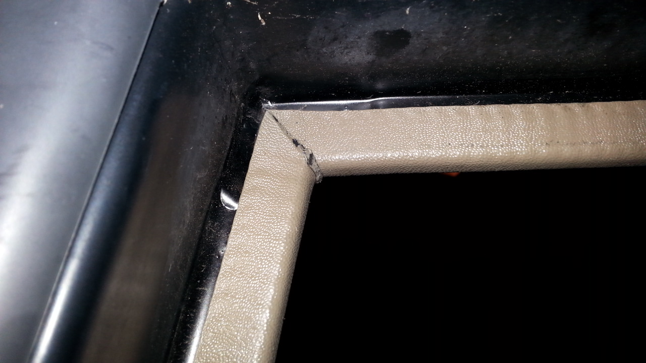

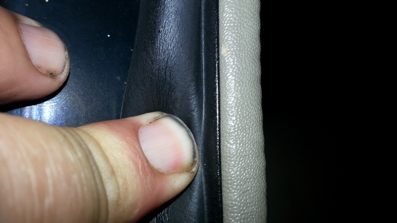

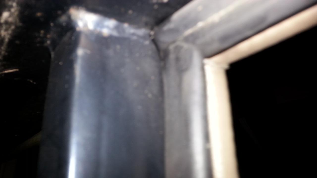

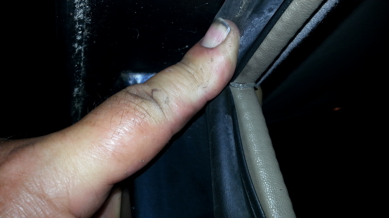

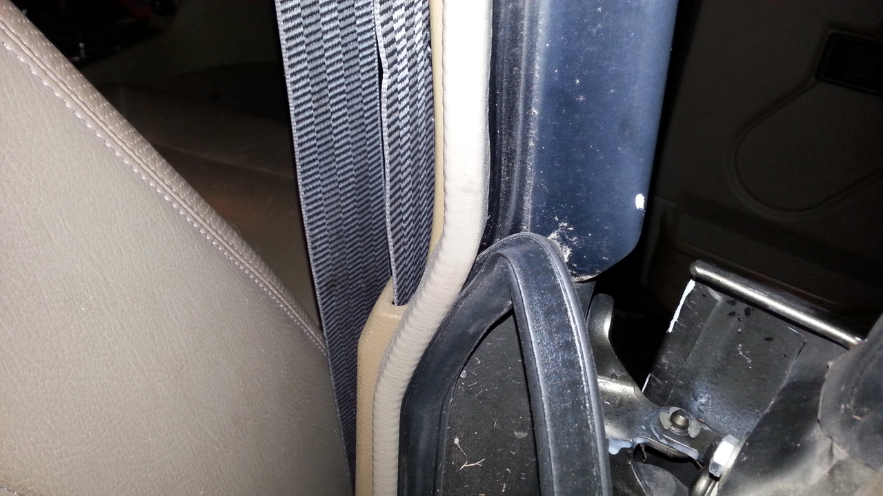

Not falling apart.
Attaching some pictures of the stripping on one of the rear passenger doors. Also some of the front doors which are not falling down. Do not see any body lip. Unless it is under the tan-ish bits. None of the weather stripping is under this trim piece. All of the bits that are in place are just adhered to the tan-ish bits.

The door seals are attached to the tan piece, which pushes onto the metal lip. D2 seals are a perfect fit and are thicker (seal better).

Forgot to mention that fish, see how they look flattened? They probly leak and glued will still leak just get d2 seals

Thanks fishEH,
Got a set of D2 seals and yes, they are thicker.
