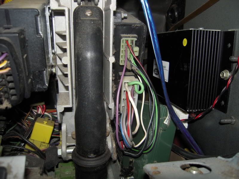

I didn't even pull it, I simply used a jumper from the top left terminal to the top right (purple) terminal and have had no problems. Did this today.

Could you be a little more specific? What color was the top left you were referring to?

Ok, I don't have a paint diagram on my mac so bare with me, leave both plugs connected, the lower connector has 8 pins I believe with the top left (closest to windshield and driver side) being a white/pink tracer wire, (it was hard to see the pink tracer on mine), the top right (closest to windshield and passenger side) being a purple with a maroon/brown tracer, I just stripped a 3 inch piece of wire on both sides and stuck it from the back sides to both pins. All windows worked, no splicing of other wires. No problems at all. Mine is a 1996 Discovery SD

Just took a picture for you, in almost the very center is a green wire that looks out of place, its just pushed in backside to those two (white/pink and purp/brown) wiresName:  DSCN0747.jpg

Thanks a bunch for taking the time to take the pic, Sleepercoupe...you rock!

Yes it works, did it with a short piece of wire and the back windows work. Its the first time they have worked since i got it, i was a little let down with how little they open how ever.

A simple fix and thanks to sleepercoupe...save the aggravation of removing the circuit board, etc.........
