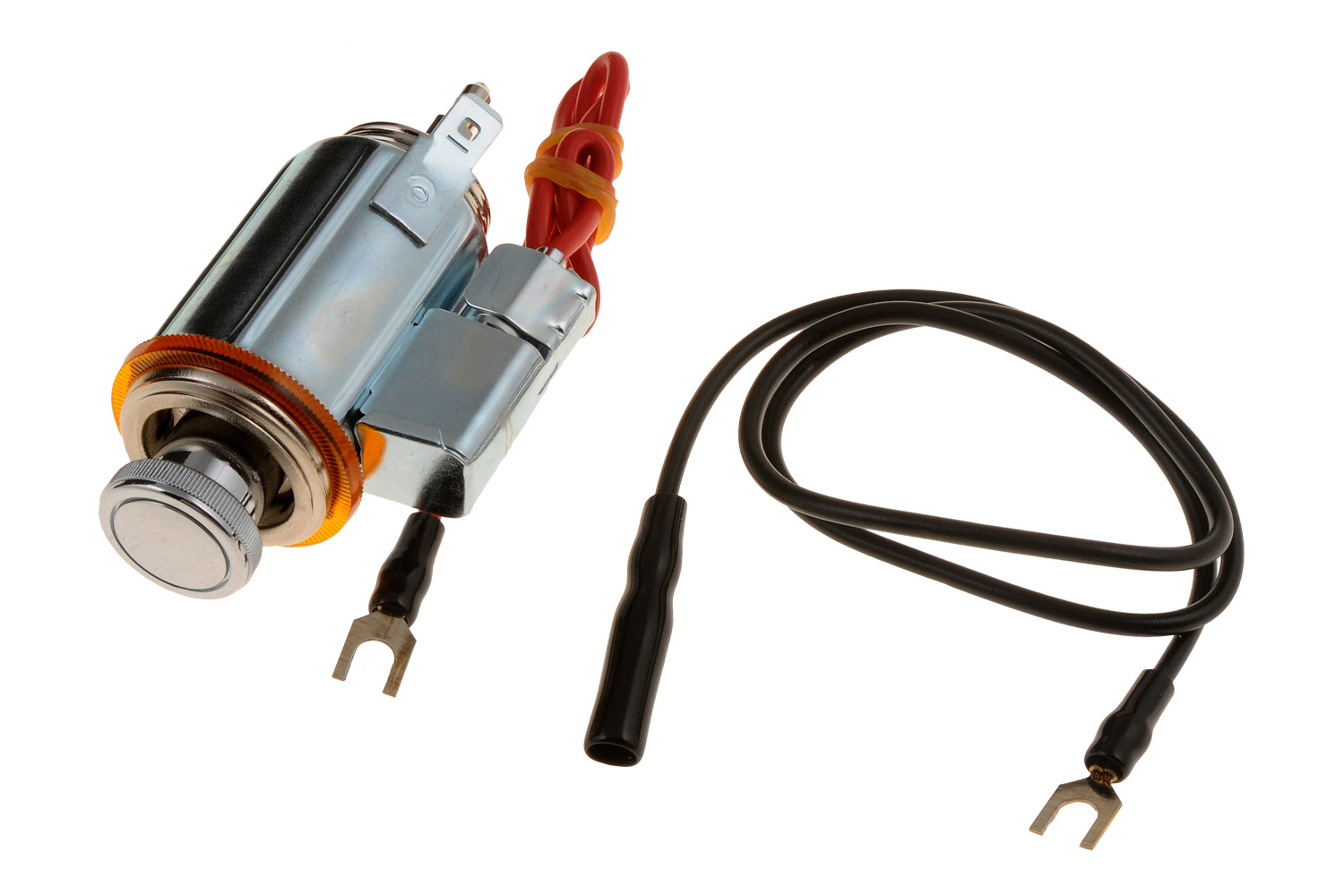

It has taken a few weeks for me to tell anyone about this, rather embarrassing actually. I decided to replace the "cigar" lighter in my 97 Disco with something that would hold a charger. I read up on what others had used, how they did it, and ordered the Dorman 56417
http://www.carid.com/dorman-interior...-26995156.html
Installed it. Then to test it out I pushed in the lighter part of it, it popped out red hot... Success!
Flash forward a few days, I remove the lighter part & plug in the usb car thingy for a standard android phone. It caught fire.
Poke fun if you must! Then please could someone explain what the hell just happened, and why so I can fix it. Please and thank you.

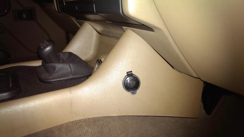

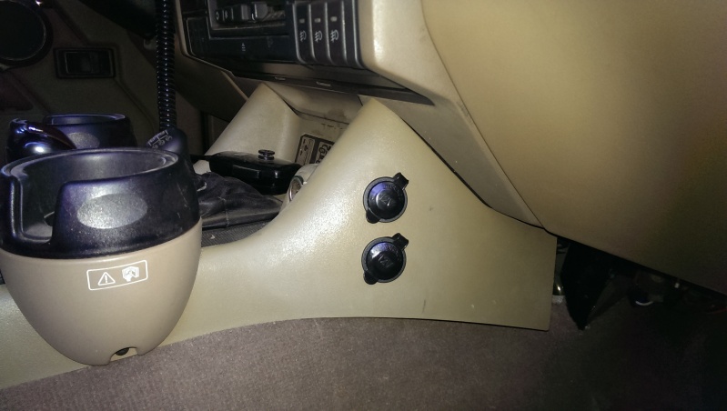

I bought a 5-pack of these off ebay. Put two in my trail truck and 1 in my daily driver. Amazon.com : Deluxe 12V Receptacle : Boating Electrical Equipment : Sports & Outdoors
Chargers fit properly and won't catch on fire. The best part is I wired the sockets straight to the battery so they're always hot. Meaning I can charge my phone for a few hours without all the truck's accessories wearing down the battery from the key being on.

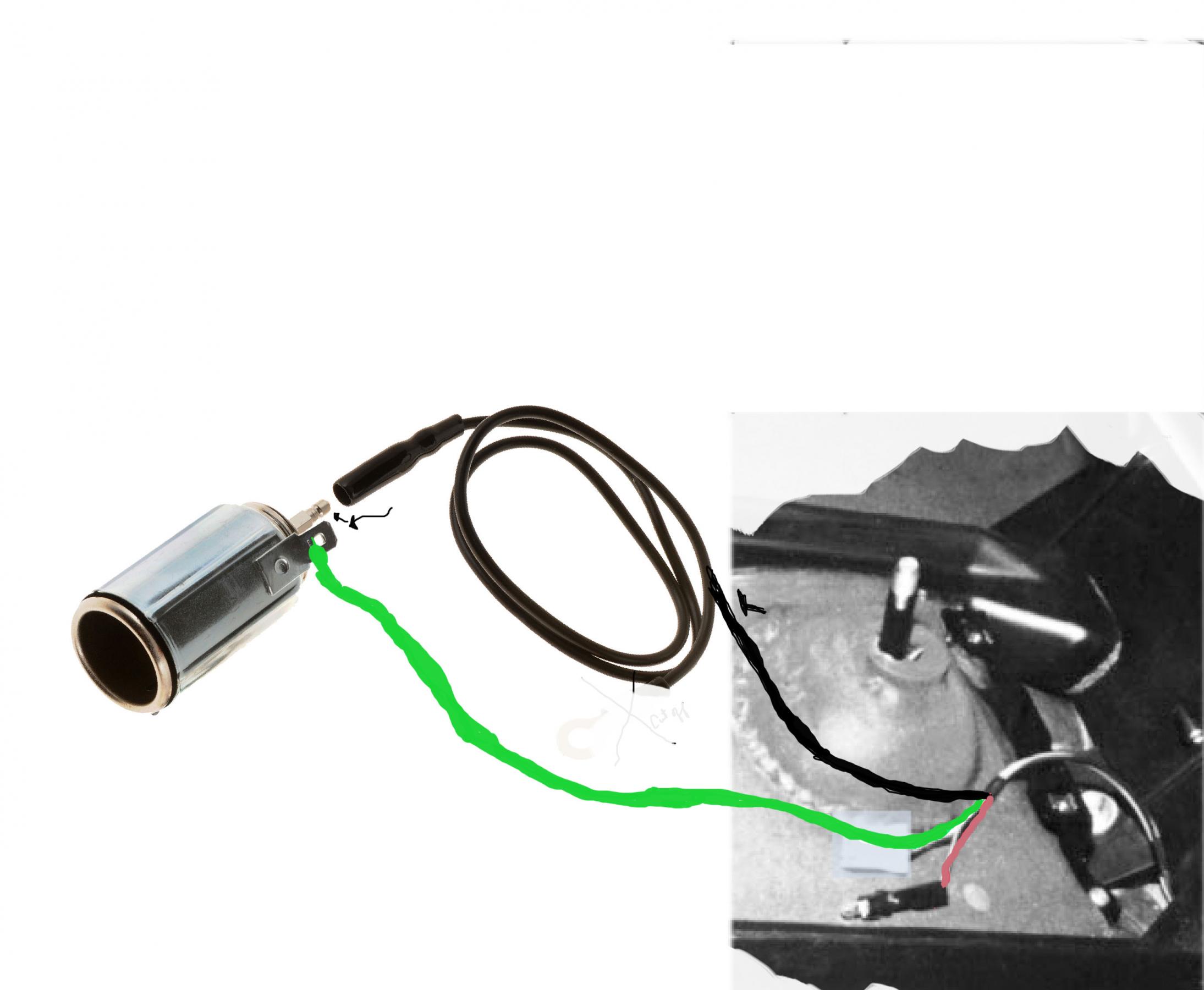

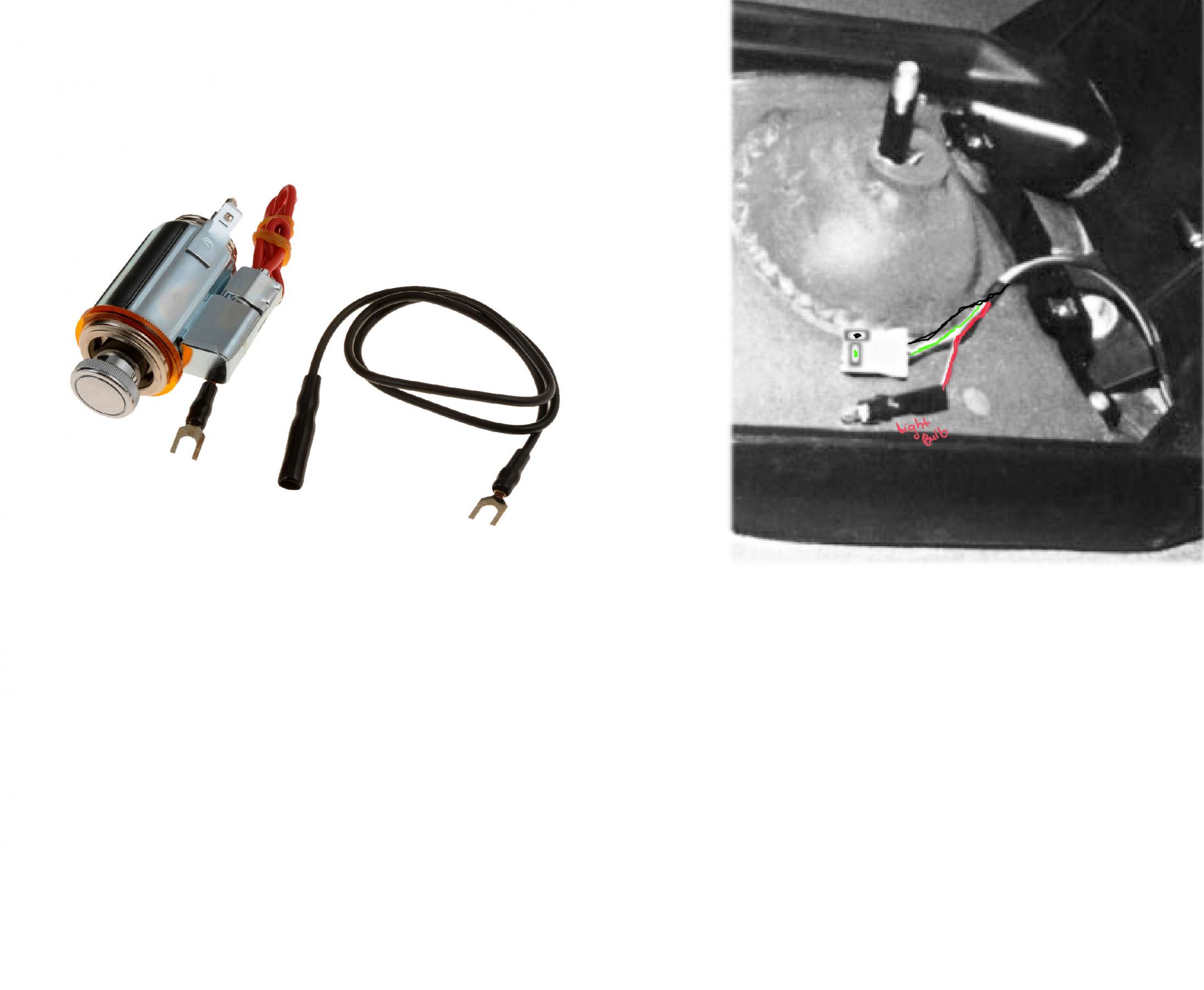

So I diagrammed my dysfunction. Here's what I had to start with: the 2 wires on the clip are LGW & Black then the 3rd which is red goes directly to the bulb lighting the ring.
What I did was attach the black wire from the rig to the end do-dad ( I read someone else's post who said they wired theirs this way) and the LGW wire to the outside. I left the red connected to the old light socket with no bulb in it because I can do without the light-up ring.
I tried to read the electrical part of the rave for some answers, but coming off of a 24 hour shift makes the words run together, and it quickly hypnotized me right to sleep.

Think you wired it backwards, black should be ground, and hooked to the flat connector on the outer shell of the socket
The green should be + or ignition + and hooks to the plug in, the center of the socket
By wiring it in reverse you probly fried whatever you plugged in
