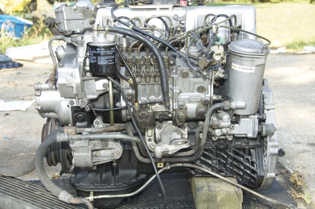

The engine that's going in... (MB purists ignore the oil lines/cooler and engine mounts as they where for an SD not a w123 and had been added to the engine after the rebuild, hence their condition compared to the rest of the engine. They are of course changed over to the w123 version now...)

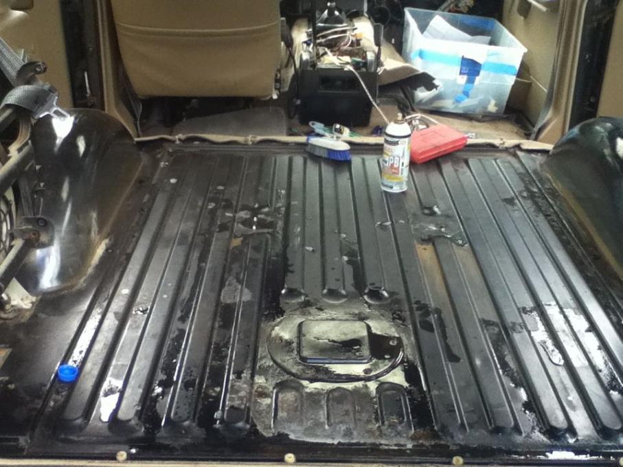

bed...

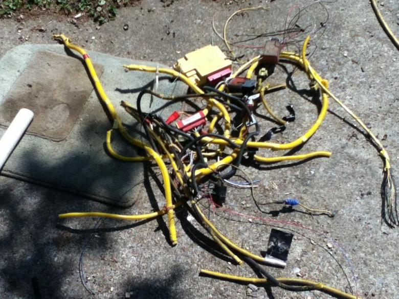

Just a small part of the wiring removed... Times this by 5 when it was all actually done.

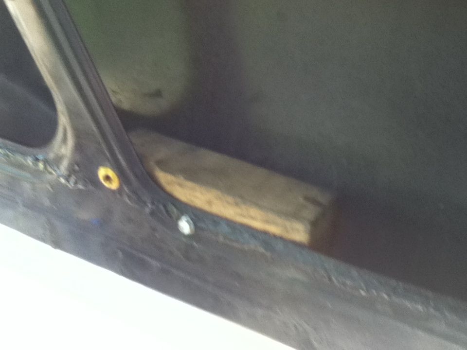

PO's solution to failed window regulator guides...

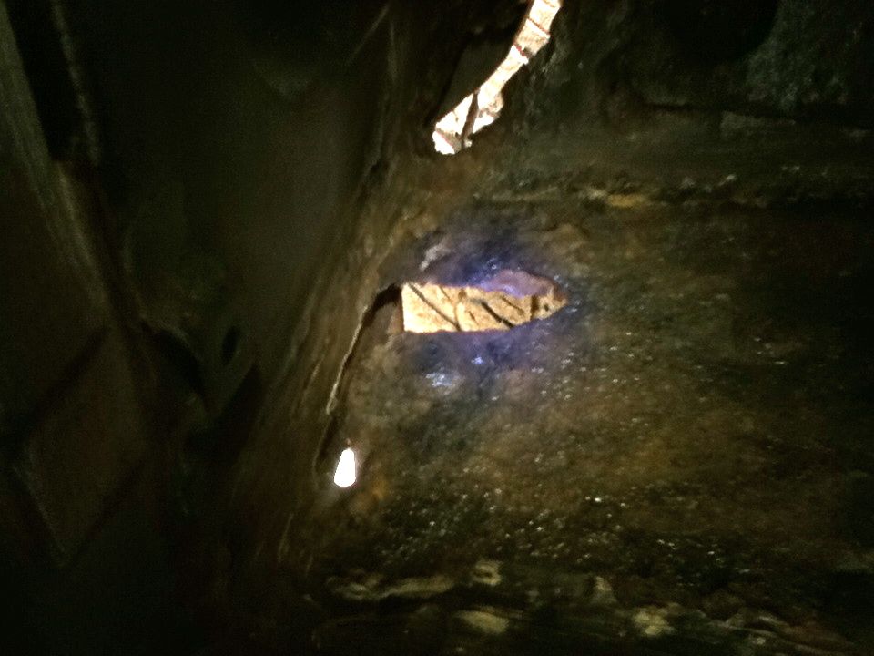

Rust hole in front drivers corner (has been replace with new steel)

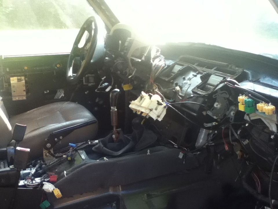

Dash out...
