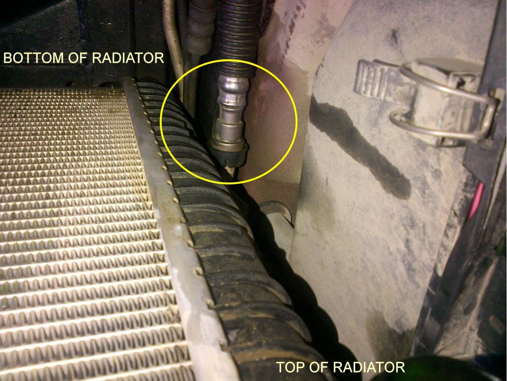

I am hung up in trying to remove the oil cooler lines as shown in the pic. RAVE says to "push" against the coupling. I tried every way to turn, push, pull..... but no luck. Any ideas?
HELP PLEASE??? THANKS IN ADVANCE!!!

I believe you push the hose in toward the cooler, then pull that blue collar toward the firewall, then pull the hose out.
Be careful you get the lines reinstalled all the way. You wouldn't be the first to have that hose blow off on the highway and get oil everywhere.

I ended up not messing with the removal of the oil cooler lines. I unbolted the oil cooler from the radiator. I enlisted my wife's help to raise the radiator from its perch and jiggled the oil cooler assembly out of the radiator. It did take much jiggling at different angles coupled to finally get the oil cooler out.
Now... for the next challenge, trying to mount the oil cooler into the new radiator assembly.

When you reinstall the radiator with the coolers still hooked upto the lines. You need to walk the coolers up. what I mean by walk, is move them side to side while lifting them up (one at a time) so the pipes/hoses can clear the brackets on the radiator.
