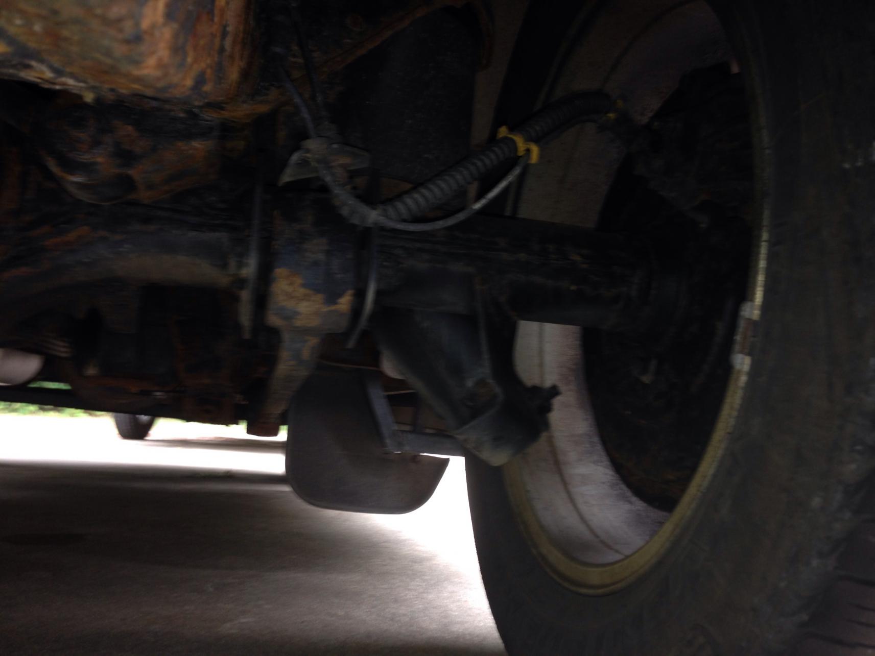

Woke up to an extreme right rear leaning '04 disco. Picture attached. It's as if I have a dead flat tire, but tires are inflated proper.
I'm kinda panicking. Is this just a shock or coil problem? If so, expensive to fix? Or something one can do on their own?
Pre-Thanks for any advice. I need it, brothers.
Sorry for the upside down pic. Can't get it right side up on the iPad.

looks like you have a bad air bag on sls suspension. if you have coil suspension, it is broken.
take a picture of the axle, behind that tire
edit; just saw that it is a 7 seater, so probably sls. you can fix it or do a coil conversion.

It's attached. Does this help?

You need a rear air bag. Its an easy diy job. I'd recommend replacing both if you could.

yep^^ as easy as changing a tire.

So, I hate to state captain obvious for you guys, but I just jack it up, take the tire off and this thing will be staring me in the face to change? I'm about to google it, so I hope the tutorial is there.
Again, thanks for the help. About to order the part.

yep, really easy. take off hose, twist bag out. put new one back

I'm going out on a limb and guessing you live up North Are you sure your frame didn't rust through
