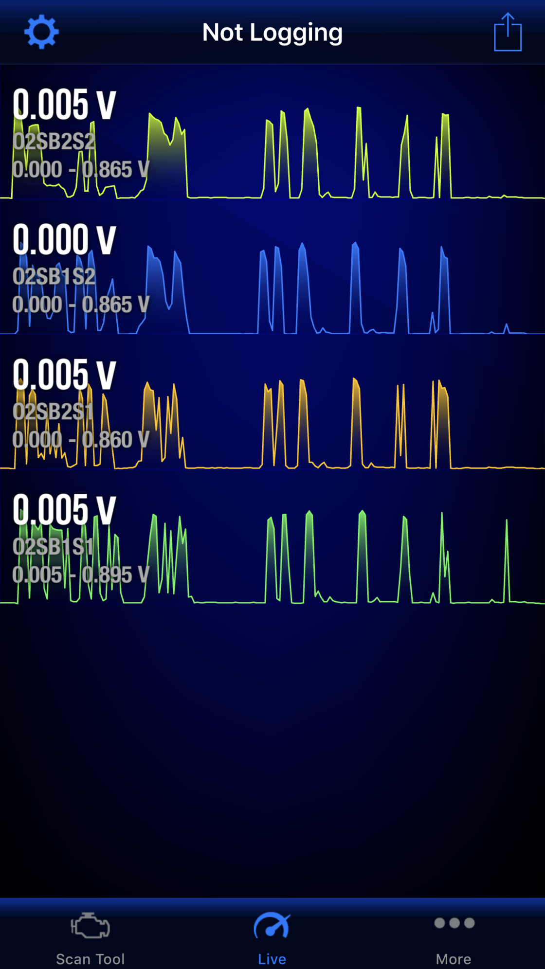

I'll attach a few diagnostic photos so you can see what I'm seeing. Observations:
1) it idles rough, and generally gets rougher once it's warmed up good. Right after a cold start, slightly elevated rpm (as expected) and not so rough
2) the trims at idle are all pegged at 25% on my live data. If I accelerate away from a stop sign, the short trims both go down and go negative while accelerating. At speed and backing off the gas, the short trims go back and peg at 25%. Long trims stay at 25% pretty much all the time, cold, warm, stopped, accelerating, etc. The trim screen grab was done while accelerating, and the 'valleys' on the short trims all associate to an acceleration event of some sort.
3) the O2 voltages sit pretty near zero at idle, but go up and down while driving around town (start and stop type driving)
4) the MAF shows maybe .5 lbs/min at idle, and goes up to maybe 6 lbs/min or so when accelerating. Kind of in the 1-3 range while driving. It did register one spike up to 55? These numbers seem a little low to me (and 55 seems high), but I'm not sure what they are supposed to be yet.
5) it runs smooth while driving. definitely still a problem at speed based on the trims data, but it's not sluggish or stalling/surging, etc. Nice and smooth and good power

And you would be correct. Smoke test had some smoke coming up from the underside of the intake manifold. Looks like I'll be learning how to rebuild the injectors...
