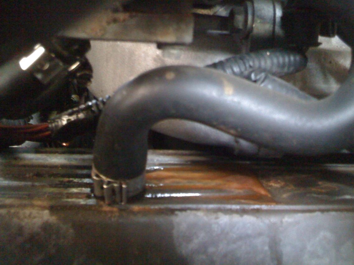

I have orange liquid(most likely anti freeze) slightly ozzing out of the hose that goes into the top of my drivers side valve cover and I hear that waterfall sound from behind my dash. I was wondering if bleeding the cooling system would fix both or does the first thing have nothing to do with that?

Fill/bleed your coolant system before you toast your engine, that is why your heater is noisy and yes, you need to get a new t/body preheater gasket kit and get that fixed "YESTERDAY".
Andunny, I just blocked off the coolant lines going to my throttle body when it started to leak. I think coolant to warm the intake air is not necessary if you live in a warm climate.

you do not need to empty the coolant system to bleed it but if it has never been flushed now would be a good time to do that.

I did the coolant bleed exactley as the sticky said. Not much happened and i didnt really get that much in the resevior till i couldnt fiil it any more. I let the car idle for about 25 minutes with the heat on blast. Is this right? Havent driven it yet so i cant tell if the water behind the dash sound is gone. I will say that it was a very light sound.
Can anyone point me to a thread on flushing? i did a search but couldnt find a real step by step.

Last question, can i really just block off that hose thats leaking? or is that a temporary fix
new thermostat comming in the mail. SWEET!
