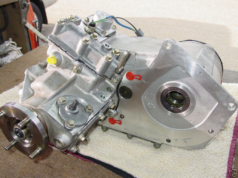

OK, dumb question (not my first and certainly NOT my last)
How do I lock my center diff by hand on my 2000 Disco????
theres a stud with a nut on top of the transfer case just up and behind the front driveshaft. Turn it about 45 degrees, I think it's a 10mm.

Here is a picture of your t/case, see the round plate with the 3 bolts and the nipple in the middle, that is it. Might want to consider installing a new linkage either from a D1 or a 04 D2, makes it a lot easier.
Do not run on the road with the CDL engaged or you will blow your speider gears.

OK, filing that info away for when I go off road in a serious place

Practice in your driveway.
You dont want to be laying in the mud looking for a nut with the wrong wrench in your hand.
