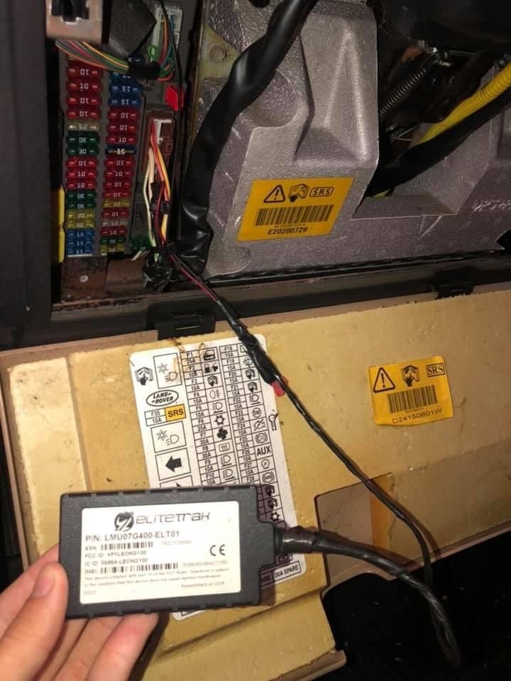

This looks more like you're have a electrical cut out - Are you turning the key OFF as soon as it stalls? Your dash is going completely dead, which if it was stalling due to fuel or other running issues, you would still have power through the gauges(dummy lights on, mileage on, gauges still reading, etc.)
No, it’s doing that itself. The whole cluster goes dead and then comes back when I cycle the key again. So the weird thing is after replacing the idle air control valve it went from shutting off 7+ times to if it does it it only happens once or twice and no more long crank as well. I’m still chasing down everything in the electrical system but everything is coming up normal. I just remembered this truck has a weird buy here pay here like immobilizer installed under the dash and I’m starting to wonder if it’s starting to act up.
