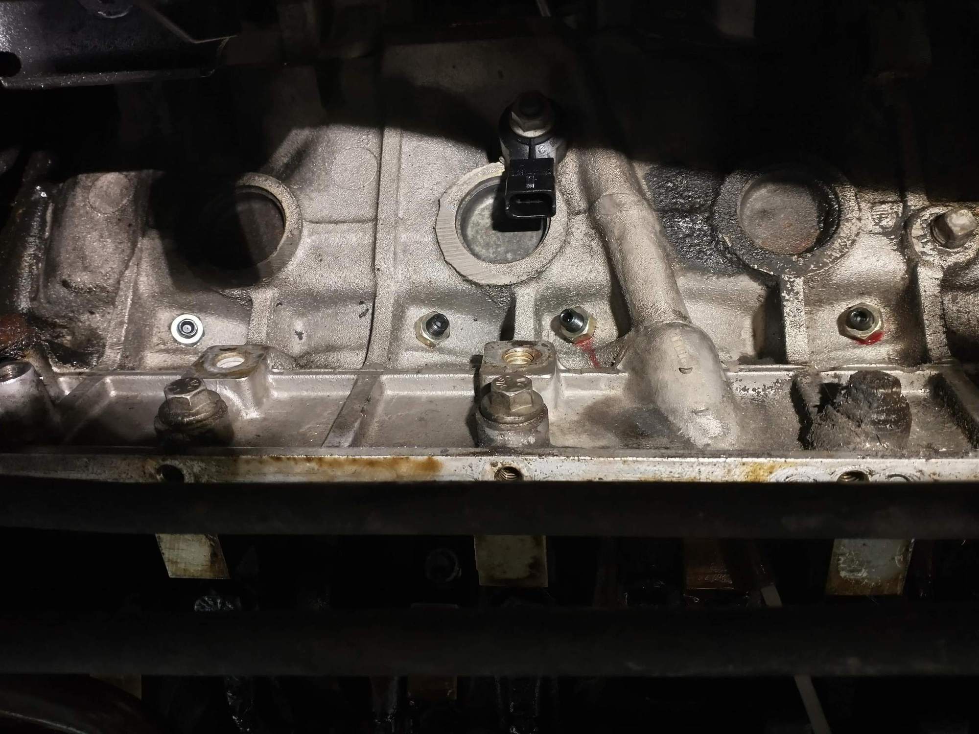

Old Jun 7, 2021 | 07:23 PM
redrover75's Avatar
Joined: Jun 2014
Posts: 1,033
Likes: 195
From: Central NJ
Default Sleeves
So, I got it back after a couple of weeks, no rush really on my part. Chris pinned the drivers side sleeves, you can see the threaded part and nut sticking out w the red loctite. I have never heard a rover so quiet!! It was a fairly big check, but a fraction of a rebuilt engine, plus I already have everything else sorted. Even a "new" block would be a huge setback given everything else. It has been >90 here since I got it back, temp is just over 200 with the extinct thermostat, no ticking. I should have done this a long time ago, I was almost ready to buy another one, or buy something practical. I think I bought myself more happy, quiet miles.
Chris is extremely knowledgeable, ever sorted out my Four Amigos, ABS fault. re-wired my MAF sensor, I had an extended it for a cone filter. He did not jump right into pinning sleeves, we explored other potential problems, sources of the ticking, plus the overall health of the engine, viability of a good repair. A completely off-the-run repair is not easy to find and people like Chris are important for keeping Rovers running. As long as it holds up, doesn't leak, this was absolutely the way to go.
If you are any where near Howell, NJ, get it done. In the Porsche world, there are shops where people ship their cars from all over the country to get repaired. I think this is probably that kind of place for Rovers.

It was $2k. About what Mercedes charges for the brakes on my GLS.
Not really that bad, the first real money I have put into it. I have lots of leakage of cash. Ill keep it forever.
He ended up having to cut the cross member and some of the exhaust off. Welded it all back together.
