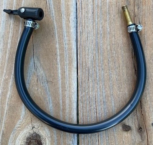

Curious to know while I waited for the pump to be delivered, I made myself an adapter. I was stuck in an RV park over Christmas so getting parts was not easy.
Just pulled together what I had in the truck and RV.
The female right angle schrader came from some extra parts in a harbor freight multi-use pump (p/n 63591 for the version I had tucked away).
The male end was from a set of air bags.
This let me attach to the schrader on the rail. With the fitting now up and out where I could reach it, I used a stick style tire gauge to read the pressure. I got 5 psi.
REMEMBER - you are measuring fuel and it is flammable - BE CAREFUL. Wear your protective gear.
I verified it was reading correctly by filling the hose with water to simulate the fuel, attaching the female end to a tire at 55 psi, and reading the fluid with the stick gauge and an electronic gauge. No reason you couldn't replace the male schrader with a pressure gauge and a hose nipple adapter for a more permanent version which I plan to do.
The new pump works perfectly.
