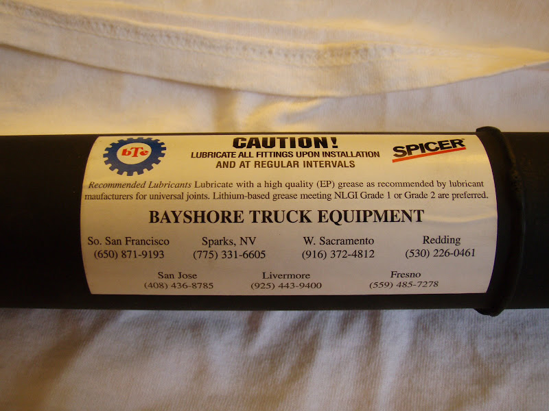

People making or rebuilding driveshafts should certify them balanced to 10,000 RPM or whatever by etching the cert into the shaft with a scribe pen or such.
Then at least you know what you got.
