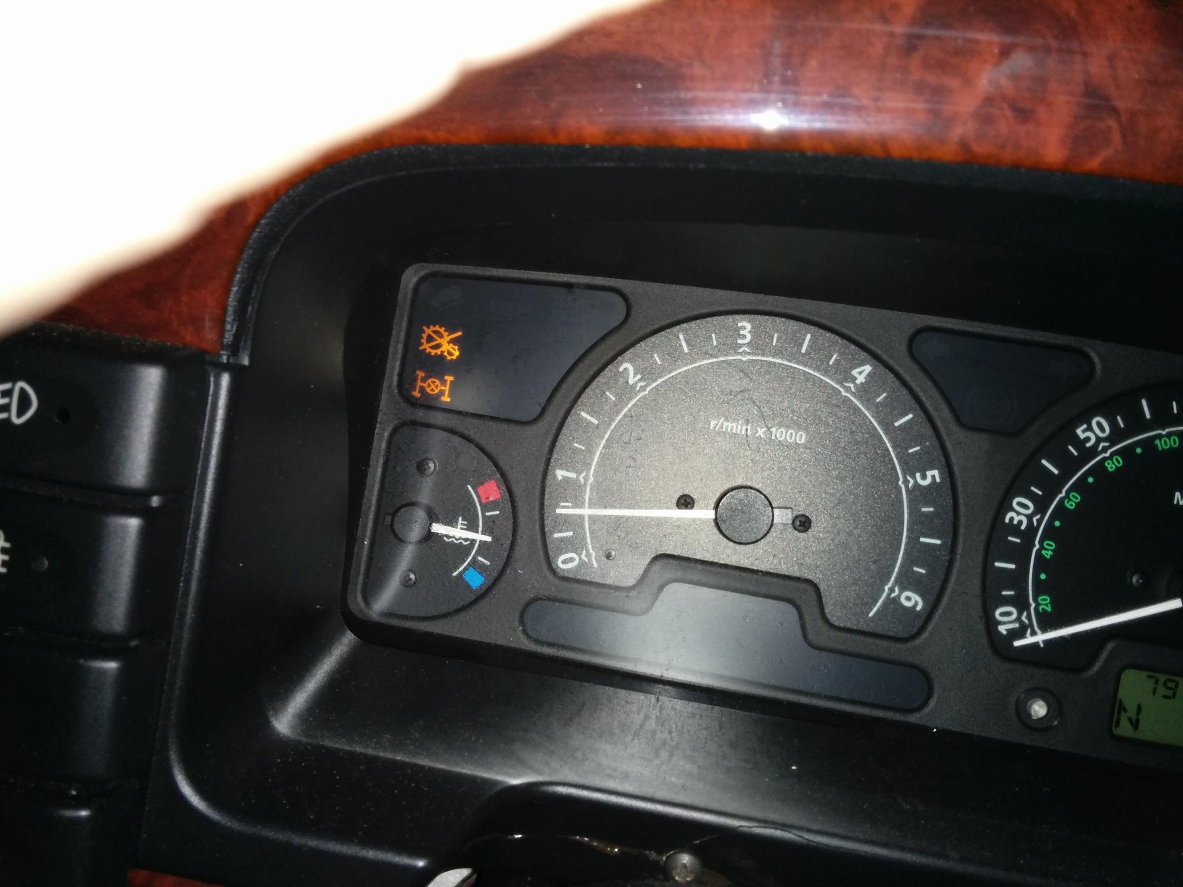

Thanks Kenso and jafir. Y'all have been quite helpful. So I've gotten up in there (had to take the front propshaft off so I insert grubby hands). In watching the motion of the solenoid, it didn't move at all when the car was put in park/neutral. Then after manually pushing it in while in neutral, it started going in and out, albeit rather lethargically. I've sprayed it down with some lubricating oil and hopefully that will help it move more freely. We'll see after it soaks in a bit.
After clearing the solenoid, I can't tell if it's gone all the way in low or not, as the "neutral" warning light is on and the warning charm is sounding. (in the attachment it's the light in the upper left)
And now that I have the front propshaft off I think I'll just be rebuilding it.
