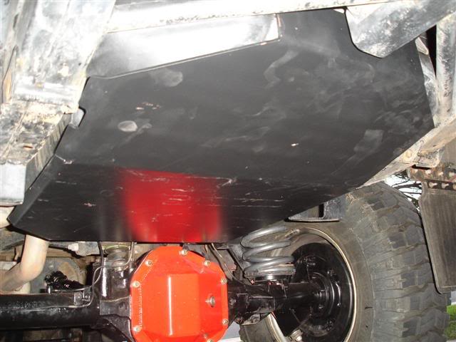

i had a salisbury (like a Dana 60) out of a D110 in the rear of my disco. that thing was overkill. nothing wrong with overkill!
thats what i'm talking about!!! is that the disco that you got into that wreck in? how hard was it to get that axle to work with the disco suspension and such? did it pretty much bolt right in?
