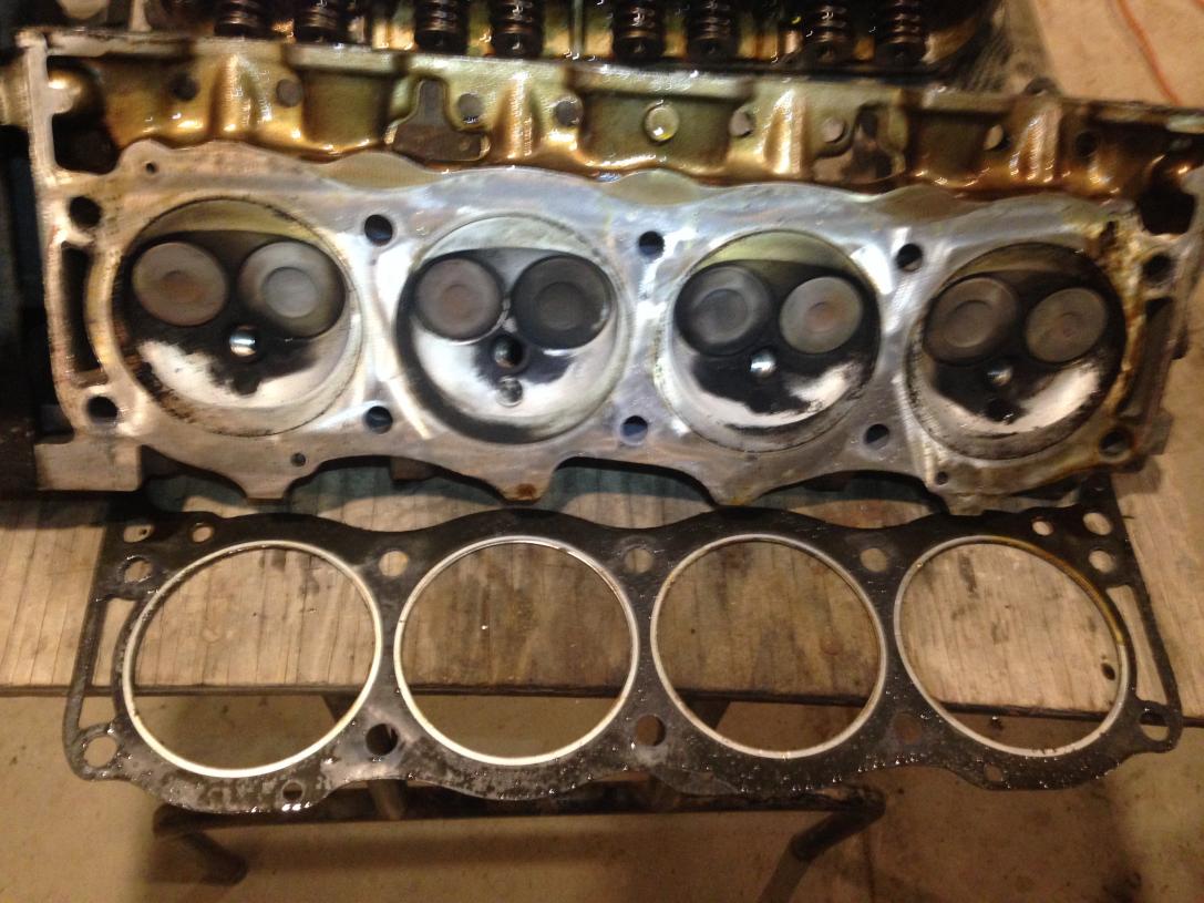

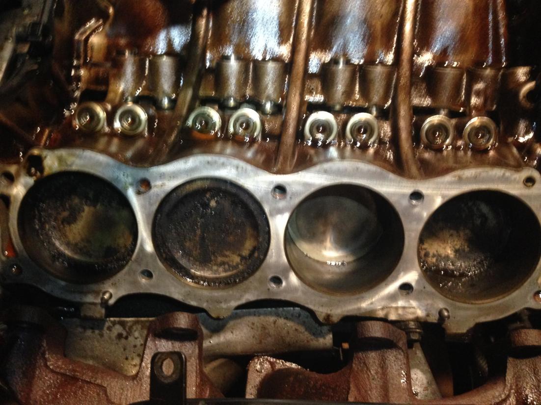

Thanks everyone for the information. Just an update, I removed the heads this weekend. The #4 cylinder was steamed clean compared to the other cylinders. See the attached photos. The actual head gasket seemed to be in good condition. There did not seem to be any abnormalities or imperfections in it. Head bolts took some effort to get off so I do not think that they had loosened up any. From what I have read about dropped sleeves, it does not appear that this has happened to me. How does everyone think coolant could be getting into that cylinder and vice versa exhaust pressurizing the coolant out of the overflow tank? I know there is a possibility of a cracked block but hoping this isn't it. I will get my heads checked for flatness to see if those are not true.

Attached are the photos

I had your exact same symptoms (according to PO) and after opening it up the exact same findings (gaskets fine) except #5 was clean.
I irontite'd it, put in a new fan clutch, radiator and the gray stat 10k miles ago. Went through a hot summer and currently going fine in the winter.

nope should be any water around there
