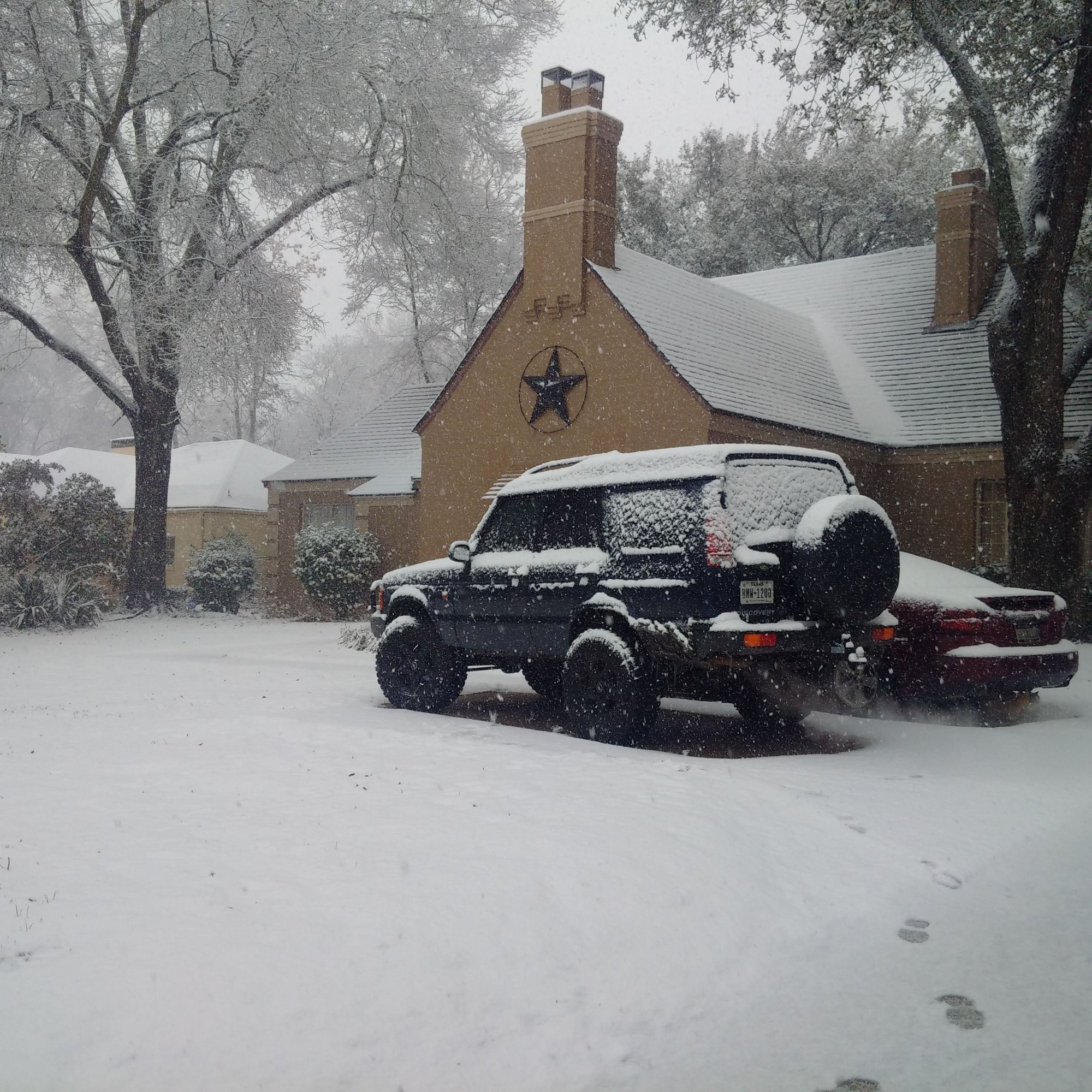

I have over 3 inches (I haven't measured but about 4) with 2" wheel spacers and somewhat fat 33s and they hit the fender when I turn and hit a dip at the same time. It is not a pleasant feeling or sound when they rub (with mud lugs on the tires). If I had skinnier tires it might just clear. With 35s I'd be cutting fenders for sure.
I drive 80mph all of the time in mine and mine doesn't wobble until the driveshaft is sick and dying (I'm on my third in four years).
Budget an adjustable panhard bar. At 3 inches the axle shift is noticeable to the driver side. You'll also need longer brake lines, and shocks, and your steering will be twitchy but manageable (no return to center either, so if you pass out in a turn it will keep turning! Hahaha. On the positive side no one will want to borrow your Rover) unless you get modified radius arms to fix the castor. I didn't change anything else for 3 inches. Then set aside a little money for a new driveshaft because a lift on a mature driveshaft seems to make them go boom, or squeak.
Fwiw I think 35s on a disco look great but I think 3 inches will leave you wanting more (as it did me.. So I added pucks under the spring perches for 2 more... But then I added weight). Finally, my 4.0 feels like an old Volkswagen beetle engine with 33's. With 35's you'd want to change your gears to 4.11s or more and that's when you get into some REAL money.
That 33's on about 4 inches of lift. I put the wheel spacers on because the tires rubbed inside when I turned. With the spacers they rubbed on the outside. my solution is to wait for these tires to wear out and get 31s because if I go any bigger on the lift I'll have to switch to a multi double cardan driveshaft which is also big bucks. Or get the multi double cardan and stiffer, taller springs and be almost as hossed up as you will be. Ford Bronco springs for certain years will work and give you the harshest ride imaginable. And they are cheap.
People who say you will break your diff gears with 33s are talking about hard driving, or offroad, or towing. Mine have been fine for years even though these tires are monstrously heavy and I have an ARB bumper and winch. With 35s?... I bet you would want shorter gears even if you don't do any of those things. I'm borderline slow as is.
Your spare won't fit on the back. I got an extension for mine and it barely clears the bumper.
