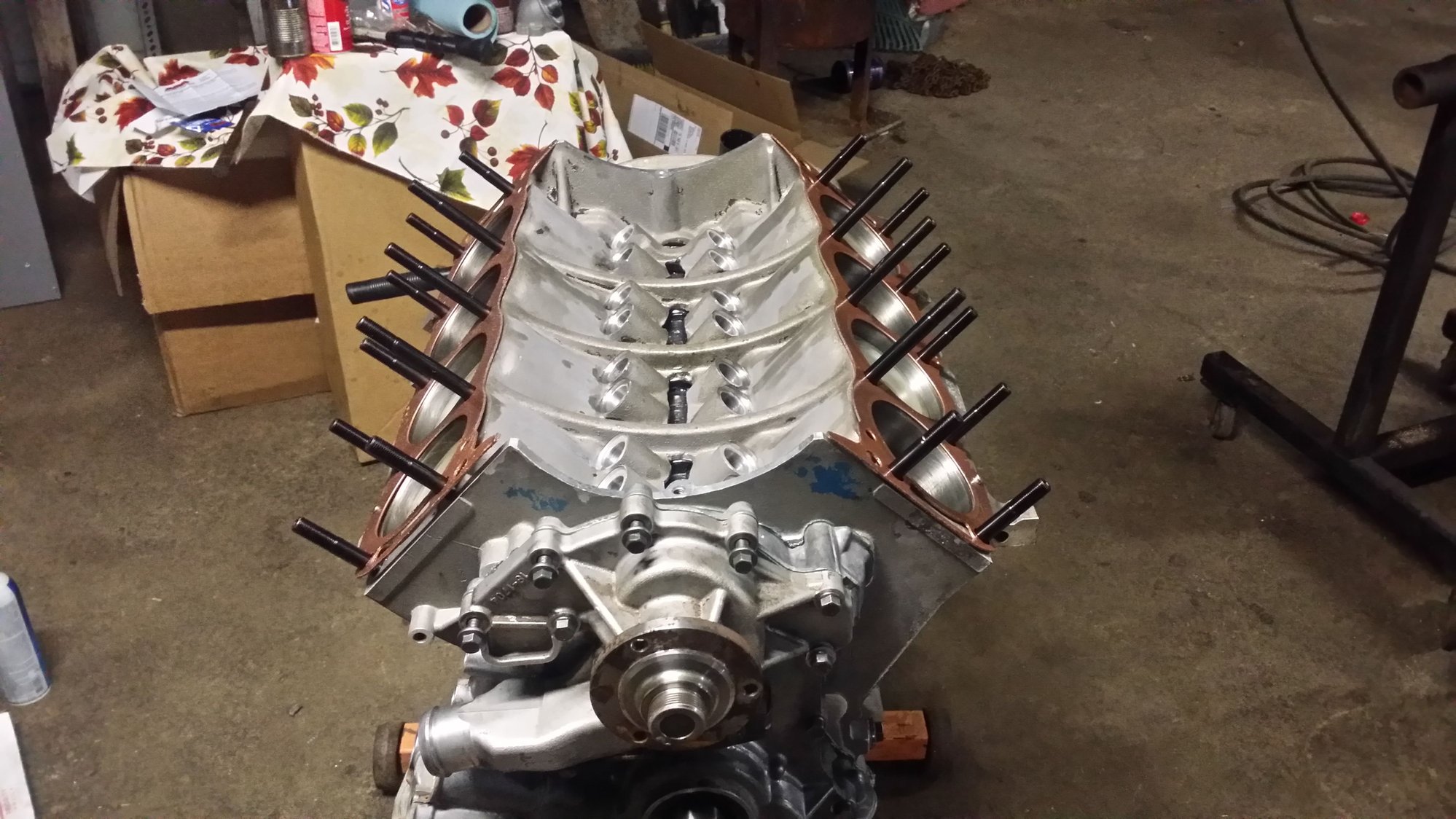

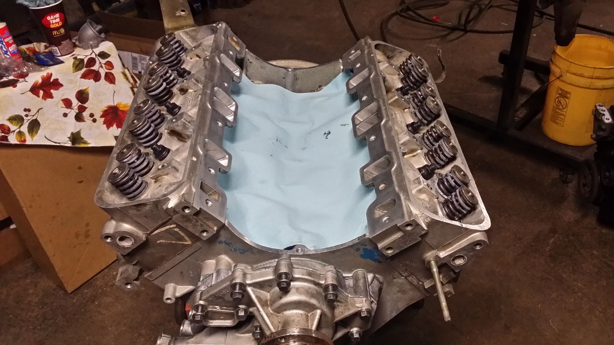

I would only resurface the heads, not mill the heads down, if you cut them down too far you can have interference/fitment issues with the lower intake manifold. port matching...go for it. I ported mine by bolting a set of intake and exhaust gaskets down to the heads and used a sharpie to color in anything hanging out past the gasket into the air flow. then took the gaskets off and ported them out until the sharpie areas were gone. After that I just tried to polish/smooth them out. Between that and the 4.6 cam in it, it is definitely peppier than a regular 4.0 is, but lets face it, it's never going to be a Ford Raptor.
Few pics of my rebuild.

hey Texas, that block/ head look great, did you have it steamed?
