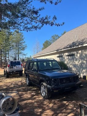

Here is the parts truck in question. I knew it had been painted due to the hood emblem being painted over, but I read to Vin, and the truck was red stock. Whoever painted it went all out, there door jams and engine bay are all blue to match. I am not currently parting it out as I may be keeping it, but I am waiting on a few things to make that call. The front bumper will definitely go though. It has two small cracks in it, but it has fog lights. If anyone near upstate SC wants it let me know.

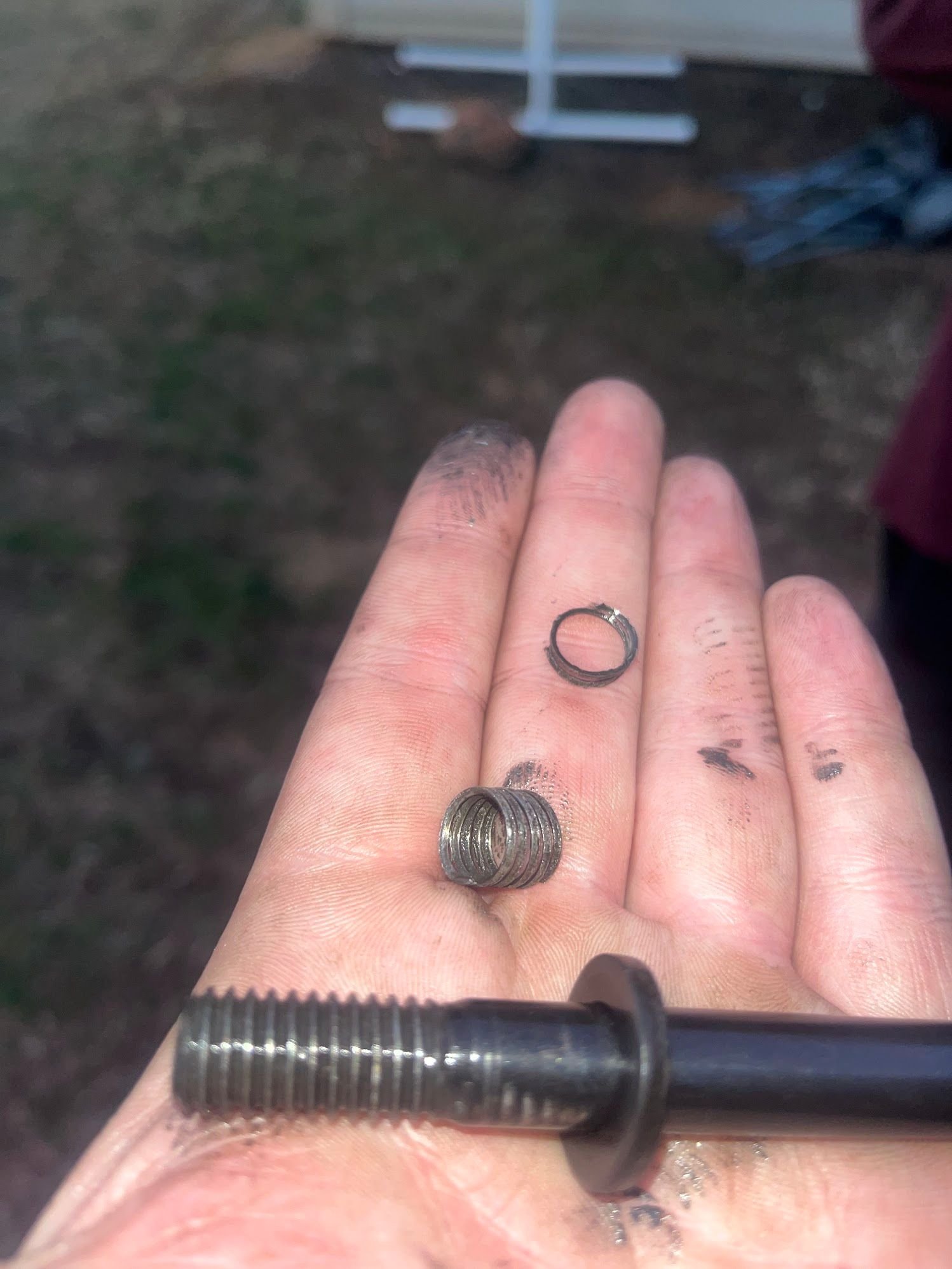

And here is why I am doing a new motor. Several threads felt weak, and this thread fully let go.
