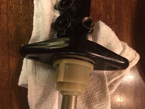

mln01...thanks for the input...I've found a used booster and will put it in. just one more QQ...see the picture below...If you can remember from 4 years ago, is the o-ring in the picture located in the correct place. Although this one looks fine, I am going to replace it. I cannot find a single diagram that shows this o-ring. I would be between the booster and the wall of the master cylinder bracket. thanks again and I'll let you know how it ends up!

hi guys! The pain is finally over! I put on the new (used) booster and installed the master cylinder back but heard it dripping in the booster again! It was a seriously a WTF moment. Took everything apart again and the master cylinder was leaking (even with the new rebuild kit). I cleaned out the booster...very little brake fluid in it...bought a used master cylinder, installed it, bled it and everything is good. It did take about 20 mins to burn off the brake fluid that got sucked up by the booster...my neighbors love me.
So my .02 to anyone with this problem...Just buy a new or used master cylinder...more cost effective in the long run!
