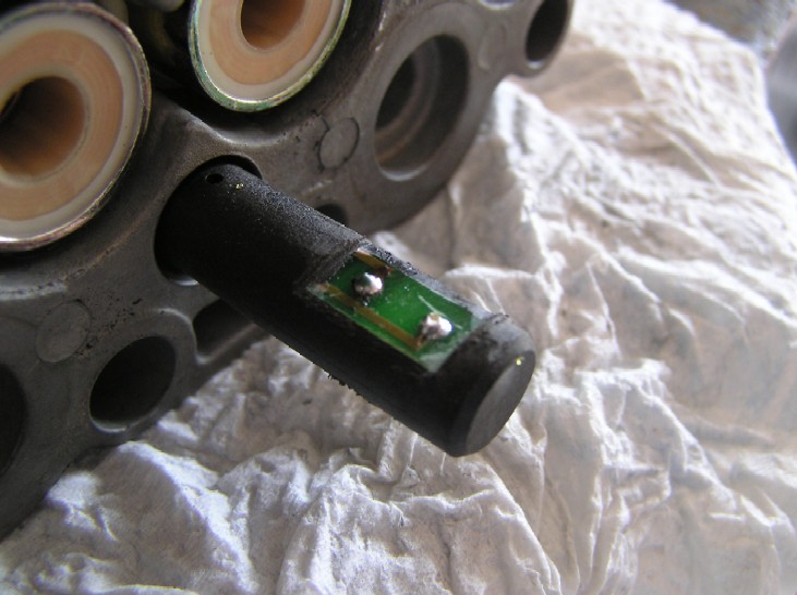

Also, its a well documented fact that quite often, the shuttle valve kit does not fix the problem, This is because it throws the same code as the actual issue,however I found some pictures of a guy who DID find the issue. It was an intermittent light, and the shuttle valve code was being diagnosed. I know what I will do ifI get this issue....
Below is inside the ABS modulator and you can see there is no solder on these 2 connections, so a bumpy road or vibration etc will "break" the circuit and cause the Amigos to appear....
Some solder was added to the connections, fault now fixed

I lost all my bookmarks when I re-installed windows (was dumb and just didn't back them up), but there is a write-up of a "servicing" of the shuttle valve. It was by a Hummer guy. Turn out the H1's use the same shuttle valve/modulator as the D2's, except that the H1 modulators are even more $$. Anyways it has some great pics of the inner workings.

Nice link, That ABS modulator even has Discovery on the sticker!!!..........similar pictures to what I posted to...............small world hey !!
