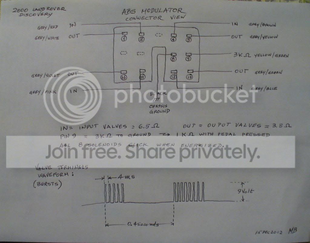

Hi.
Had this sketch among my things and thought would be good to share.
----> http://i588.photobucket.com/albums/s...ps5238b9a0.jpg
-Could be helpful to many- If convenient, please let me know and will post a copy also on a related thread. Seems the first sticky is only for the shuttle repair.
