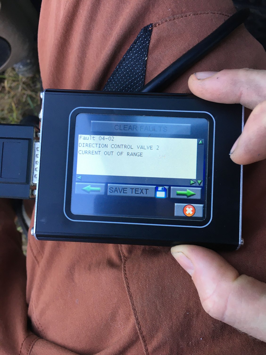

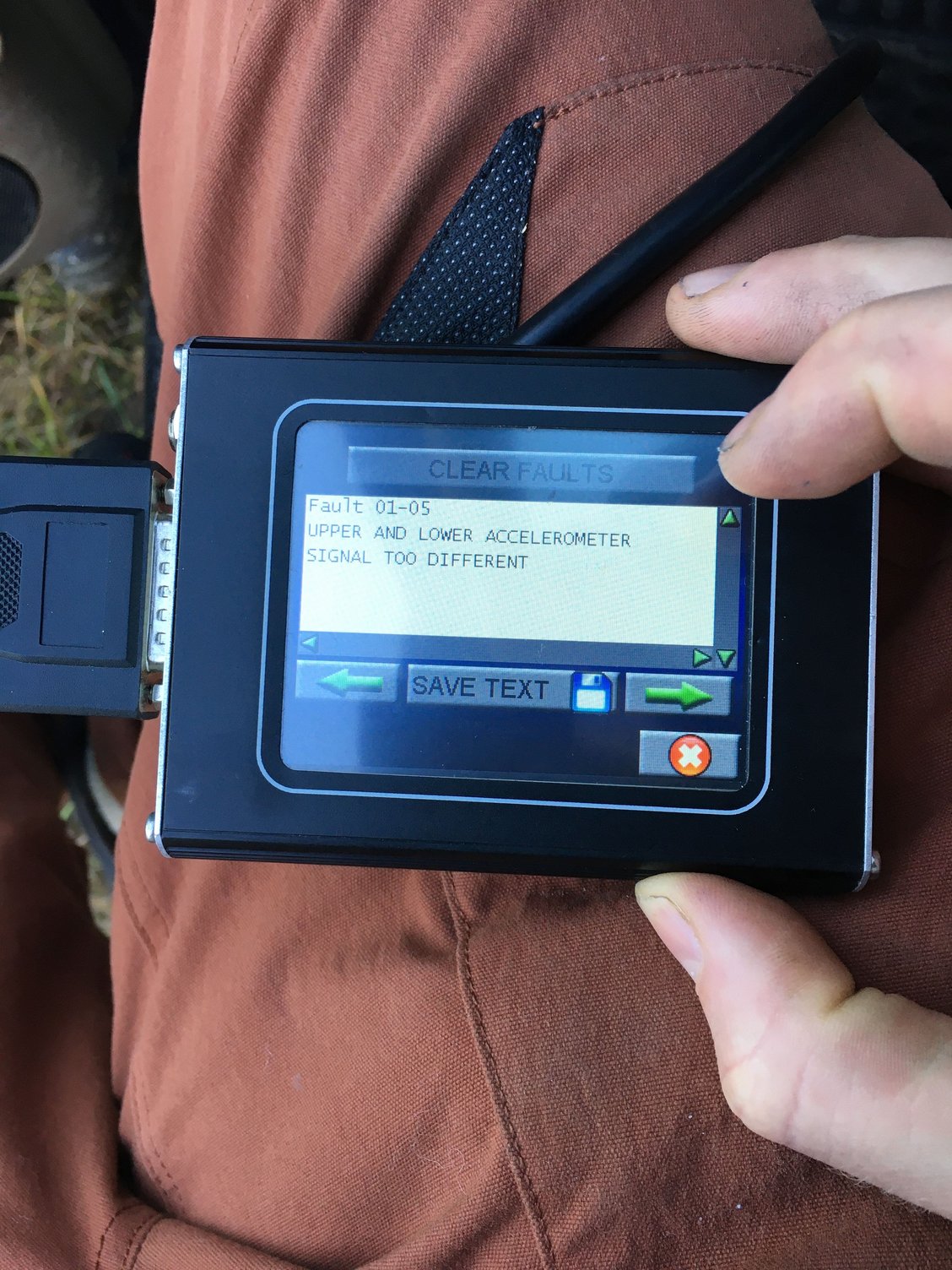

After I installed rocksliders and relocated the sensor for ACE on the rockslider, the ACE warning light started to appear. During the installation I dropped the sensor on the ground. By reading the workshop manual I found out that this sensors are fragile. So I ordered a secondhand sensor sent to me be mail. It worked fine for a week. But the warning light came back, but this time it was red and followed by an alarm. I reset the ace and calibrated the sensors with nancom. But the red warning light keep comming back.
Anyone with any ideas? Is it bad sensor or something else?
