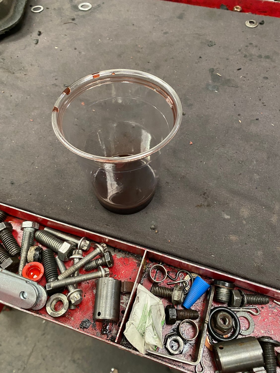

(I’ve been driving this around town in manual to take the pressure off 4th gear). (Picture attached of the trans fluid color).

Change the MAF, spark plugs, wires, coil packs and O2 sensors. Trans is fine, that code get's thrown when the MAF is starting to go out.
All of these things are easily done with a little patience and the whole lot of parts is not a large sum of money either. Coil packs are the only part that is a little tricky but it's still a simple job overall.

@whowa004 and @Dave03S are right while you are at you may as well service the transmission. Fluid, filter and gasket it is not a big deal or cost.
