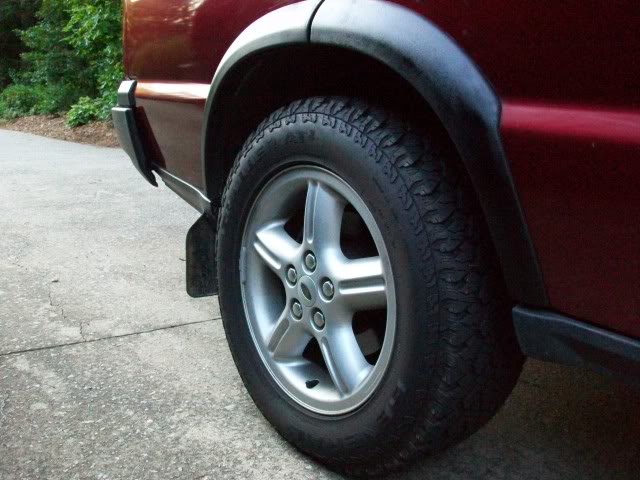

General Grabber A/t2 hands down best option for 18" wheels.
Price and performance. I've been very happy with them.
They are quiet for A/t tires on road, the are great in mud and snow too. (and they have that aggressive look you're going for.)
