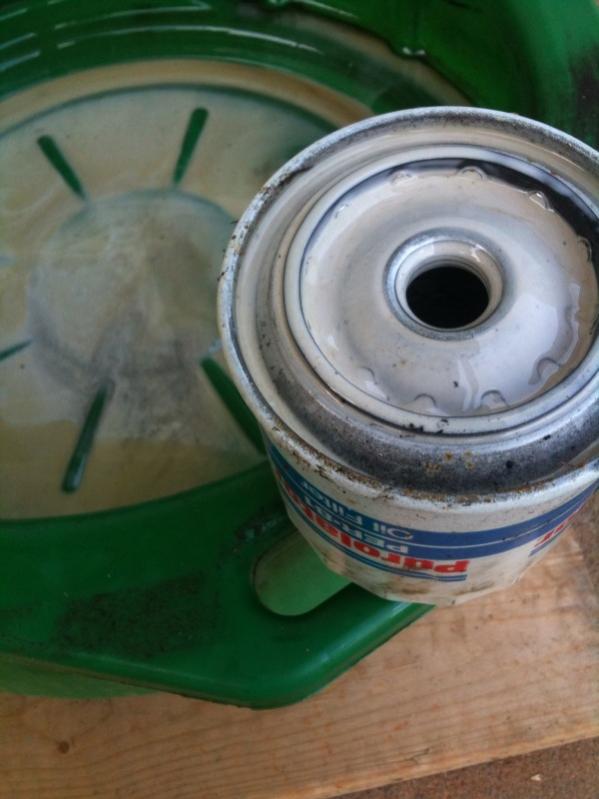

Depends.... if your oil looks like mine did, then I would take the heads to a machine shop and have them go thru it. On mine, one of the heads was warped. Doesn't cost too much. You would hate to do it all only to find out you have to tear it all down again!
Eric
