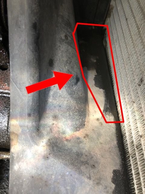

Hey after reading every thread in here about overheating I bought an UG to check the temperature. At the same time I noticed that my coolant was "disappearing" after a couple hours of city + highway driving.
UG temp shows average temp of 200F to 212F. Median is around 204F. Too hot, right? So I bought a new thermostat 180F (the grey genuine one), but still needed to know where the coolant leak was coming from.
My oil is not milky at all, so I excluded a head gasket issue.
Changing my belt again yesterday (long story), I noticed some liquid and stains in the bottom lower right corner of the plastic thing that holds the radiator.
Removing that plastic, I found quite a bit of thick liquid on the metal plate beneath it. (Picture below)
It may no be super clear in the picture, but there was quite a lot. I wiped it clean and will check it later in the week. So my best guess is that the radiator is leaking. I checked the hoses and none of them have any visible liquid or stains. They all look actually new. The radiator is from 2014, it's a nissen.

Very often head gasket leaks are external so there's no milky oil. The weak spot in the head gasket is at the rear of either head. That is where a water passage is very near the edge of the gasket, and there is only a very narrow bit of gasket.
I doubt the thick deposits you found in front of the radiator result from a coolant leak. I've never seen coolant thicken like that.
The best thing to do to track down a coolant leak is to get a cooling system pressure testing kit from any of the major auto parts chain stores. They will loan it to you for free. Follow the instructions and pressurize the system as specified. Any leaks should then be revealed.
The thick liquid is more at the back of the radiator. But not sure where it coms from. It just under the radiator, hence why I thought it was linked to it.
