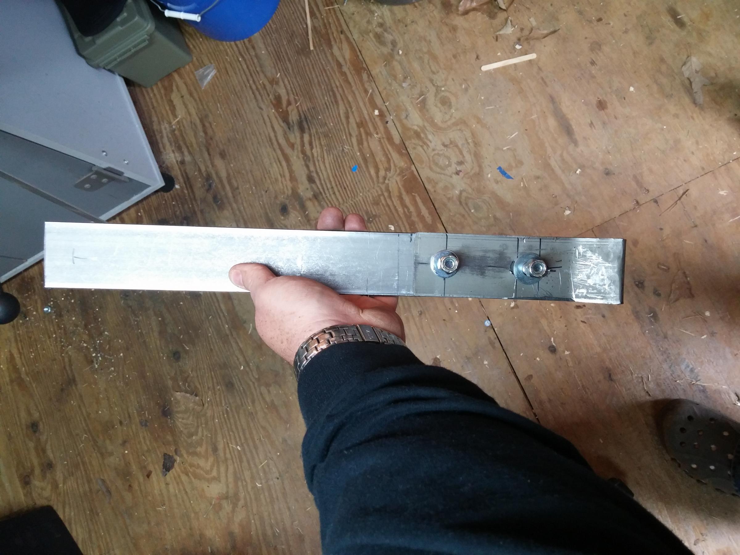

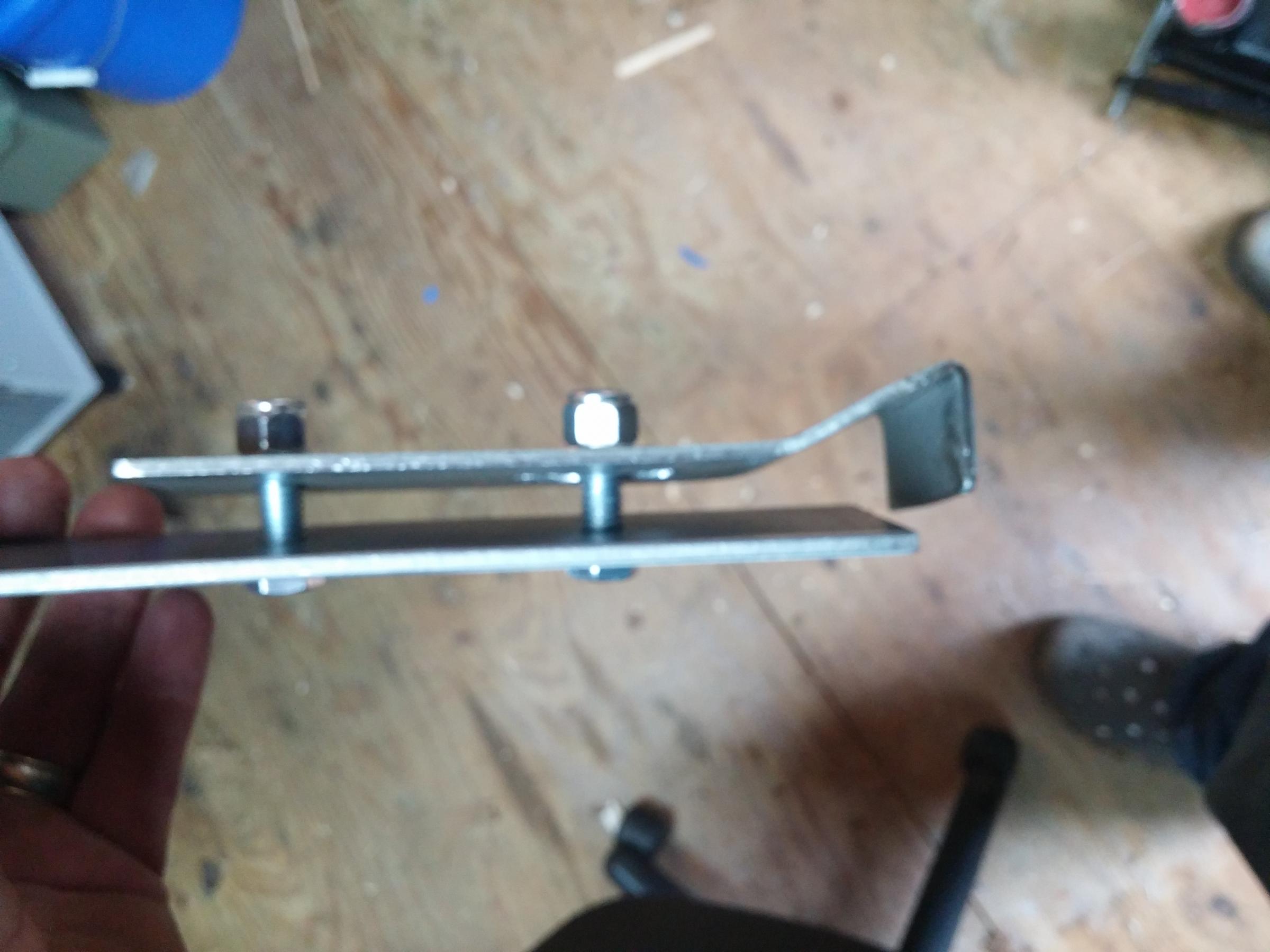

Well as the title says I'm setting about to build my own safari rack for under $300 total. Size: 58.5" wide; 89" long; 17" tall. I finished the uprights tonight. They're made from 3/16" x 2" flat bar cut to 17" length. Everything will mount to the drip edge like normal. I made the outer clamp piece out of 1/8" x 2" cut to 7.5" in length. The lip is 1" deep with a bent offset to clear the channel better. The 3/16" flat bar has two holes drilled and threaded (3/8"-16) at 2.5" and 5" from the bottom edge. I have to get a spacer that's right at 1/4" thick (Will probably use a standard 3/8" nut) to prevent the drip edge from being excessively pinched/deformed.
If anyone has any suggestions I'm all ears.

one suggest would be to slug the inside of all your connections before you wield them.

Drowssap, thank you.
