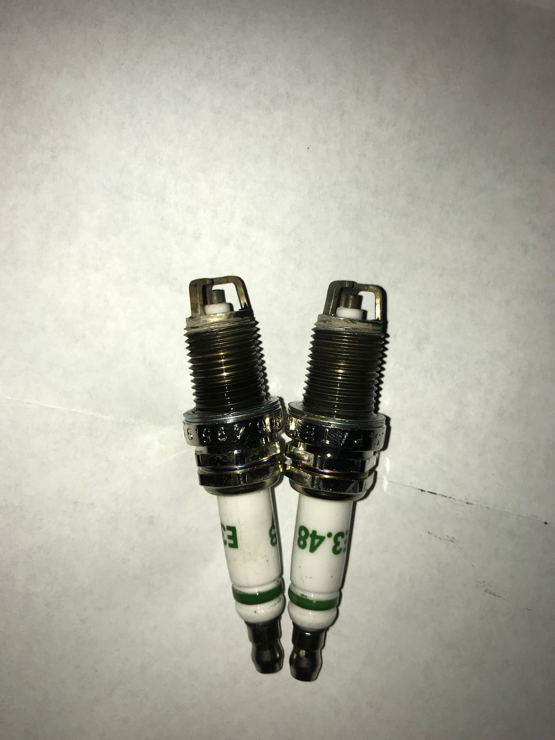

Might wanna try a regular plug like an Autolite Double Platinum or NGK vs the E3’s. If the wires/coils aren’t the problem.

First picture shows the #8 plug on the left and the #6 on the right. The #8 does show some soot.

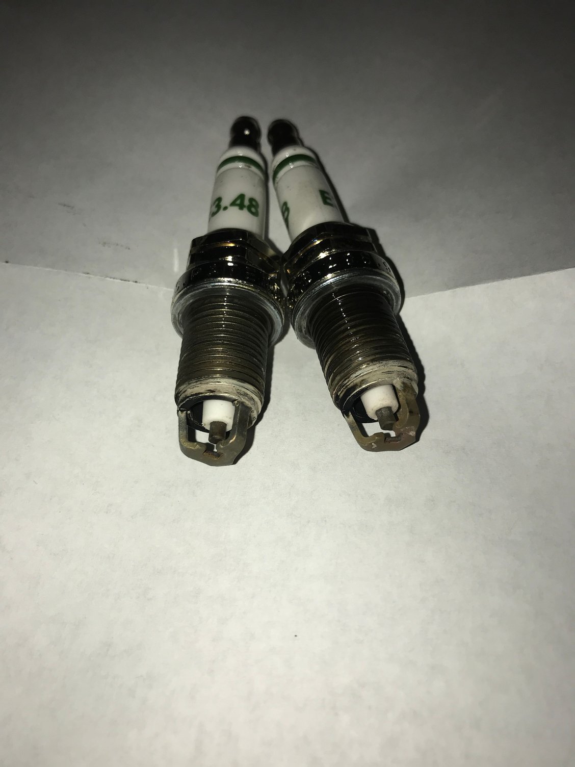

The Second picture shows the #8 on the left and you can see the electrode looks fine but I swapped them and we’ll see if the misfire moves.

So after work today the SES light came on as expected, but it is still on cylinder #8. I’m at a point now that I will neeed to do a compression check and maybe a leak down test too. It’s driving me crazy since I’ve already dumped so much into this rebuild.
