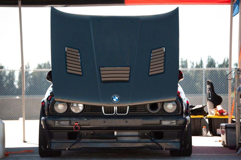

Hood louvers? Pro tip don't buy the parts store chrome stick on ones?

Hood louvers are cool, not pun intended, but can often result in higher transmission temps since air volume that normally goes past the engine and down through the transmission tunnel is reduced. Have you verified actual air intake temps at the source with an external sensor?
