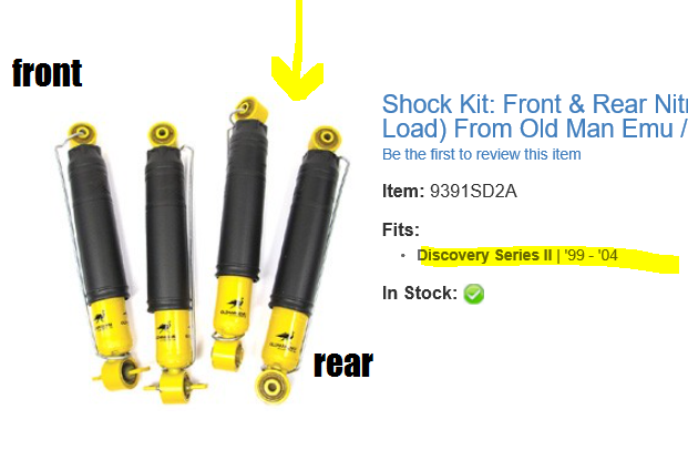

Rear shocks on a DII are eyelet top and bottom. The DI has the eyelet on top and post on the bottom. Look through the Bilstein Catalog for an air shock. Probably not a direct fit but you might find one that would work. Bilstein, Innovation and High Quality Since 1873
If you want to replace the springs it's a very simple job. Have a look >

OverRover,can you send me the link to those yellow shocks in your post.
Are they of the "self-leveling" variety?
Thanks.
