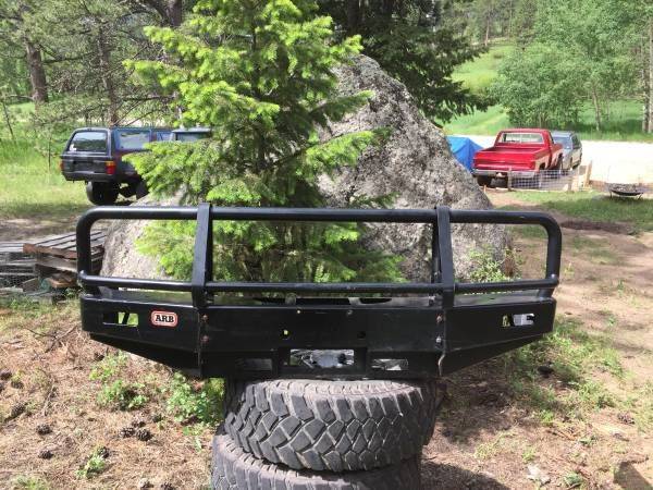

Quick question. I found an ARB bumper for sale cheap. I looked at the new ones for sale and they list it as being for 99-02. Will this fit on an 03?

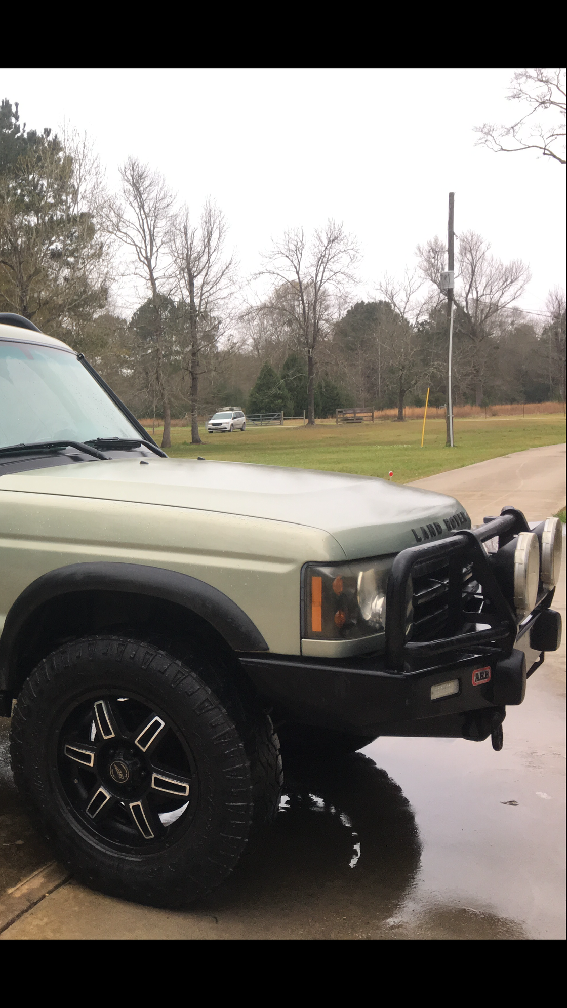

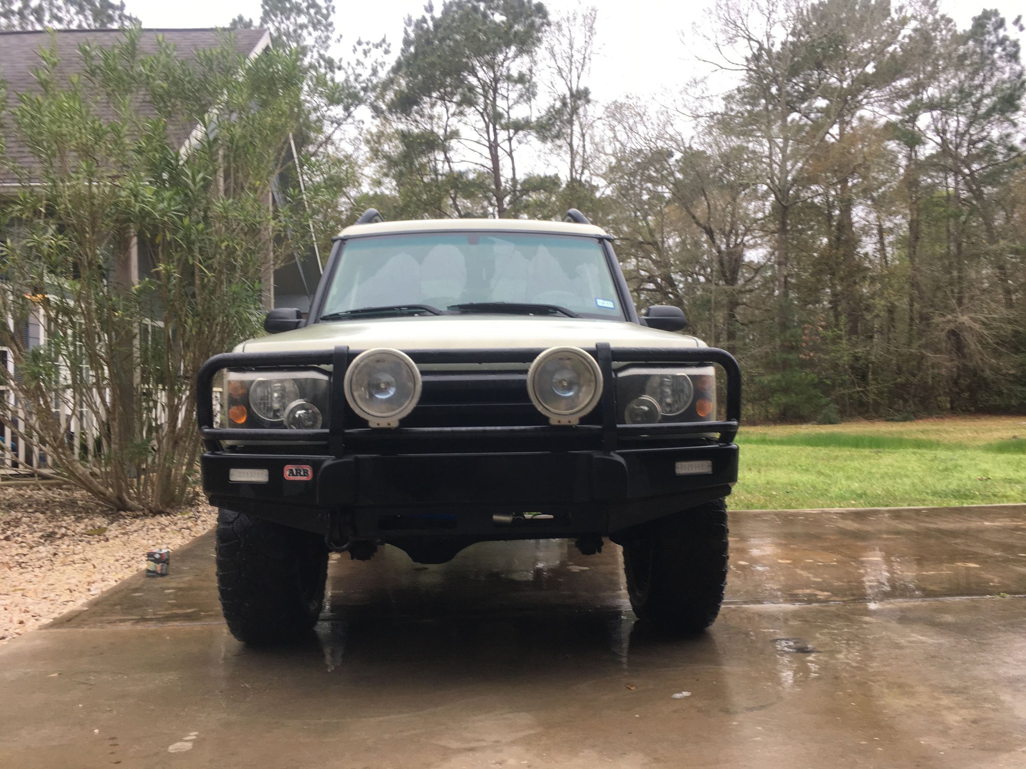

99-02 D2 bumper on my 04. IMHO it lines up with the fenders better than the 03-04 model. Only difference is the grill shape opening at the top back of the bumper & you don’t notice it to be honest. I prefer the 99-02 ARB look vs the 03-04 myself.

Yep That is the bumper. My 03 is silver so I got a good idea of the look from your pics. Thanks

No problem at all! I got the clear replacement LED’s from Australia for like 30.00 shipped. I think the clear matches up to the 03-04 better vs the amber ones.
