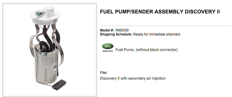

So out of curiosity I just went to the AB website. They've edited the descriptions of the two pumps so they now provide no information about which one goes which SAI. Wow, now you're utterly at the mercy of a rep who may or may not have a clue! Great.
Why not do what Rovers North does? Type in the part number WFX101060 (pump for SAI) and you get the first screen shot. It says, this part is for vehicles with secondary air. Type in WFX101070 and you're told the part is for vehicles without secondary air. Unfortunately, you also have to deal with the Rovers North part numbers but how hard would it be for AB to make this simple distinction. How hard would it to have been for Jim, their "tech" guy to hold up WFX101060 and say, in the video, this one is for trucks with SAI?

BTW, Atlantic British STILL hasn't really corrected the problem with their website and these pumps. In the screenshot below you can see that they are still telling people that WFX101060 is for vehicles WITHOUT SAI and that's just WRONG!
