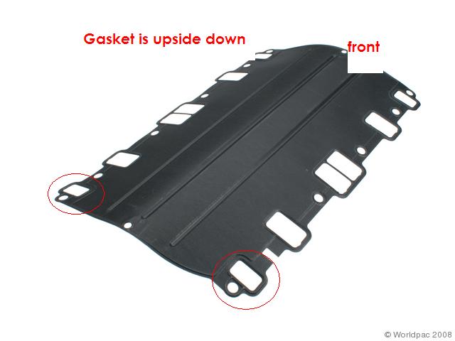

Let's calm down a bit about replacing the head gaskets. For some reason, this seems to be the cure all for coolant leaks, which is the long way around this problem.
Your intake valley pan gasket is shot and it is leaking all the way in the back of the intake where it joins the left and right cylinder heads.
The leak starts there because the two coolant passages in the heads are not blocked by the gasket but only the intake casting and due to heat cycling of the engine and coolant system pressure, it always leaks there.
So please, before you pull the heads of, change this gasket and i am sure it will cure your problem as long as you do not see seepage physically at the head gasket itself into the valley or to the exhaust manifold sides.
Gasket pic:
