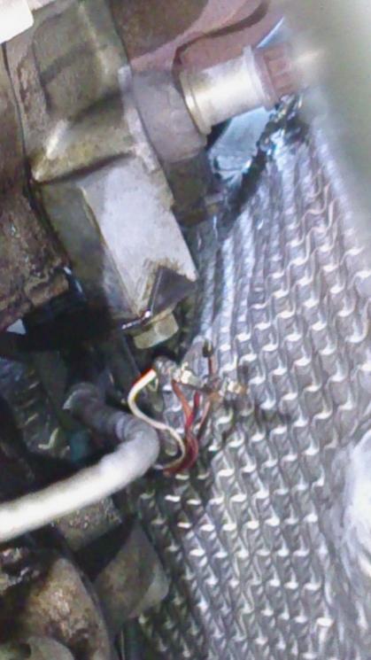

hey there guys.. i've been searching for days and hours now. i tried searching but no real luck on my topic. Originally, my rover(2003 disovery2) had a check engine light for bank1 sensor1, i peeked at the sensor and crawled underneath it, wiggled the connector and it was fairly loose. I tried tugging on the connectors if maybe it wasn't all the way connected (shouldn't be loose because no work has been done with them recently). Long and be hold, the small plastic locking pins that locks the wiring into the connector was all broken but one. Maybe have gotten brittle with the heat and just simply cracked off causing my connection to be loose/lost.
After calling dealer(not cheap) and wrecking yard, i found a whole top engine harness for $50 shipped to my door. Now my issue is, which color coded wires goes to where.?!? The pig tail cut from the engine harness i got from the wrecking yard is a different wiring colors than the ones on the vehicle. I was told from the auto wrecker guy that its the same make and model year as mine before ordering, i was even sent pictures of the vehicle the harness came from.
i tried the FSM to pin-point the wiring locations but no luck, i need to know which wires goes where on the female connector. i will still be searching while waiting on any replies here.

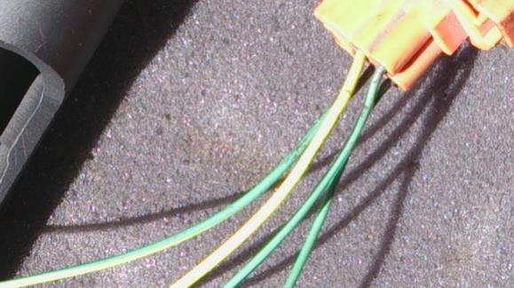

Images-one is from the vehicle and the other is from the pig tail replacement.
----from the vehicle: (red w/ black strip)(white w/ orange strip)(brown w/ white strip)(solid orange)
----the replacement pigtail: (solid black)(x2 green w/ yellow strip)(green w/ brown strip)
any help would be greatly appreciated. thanks guys.
