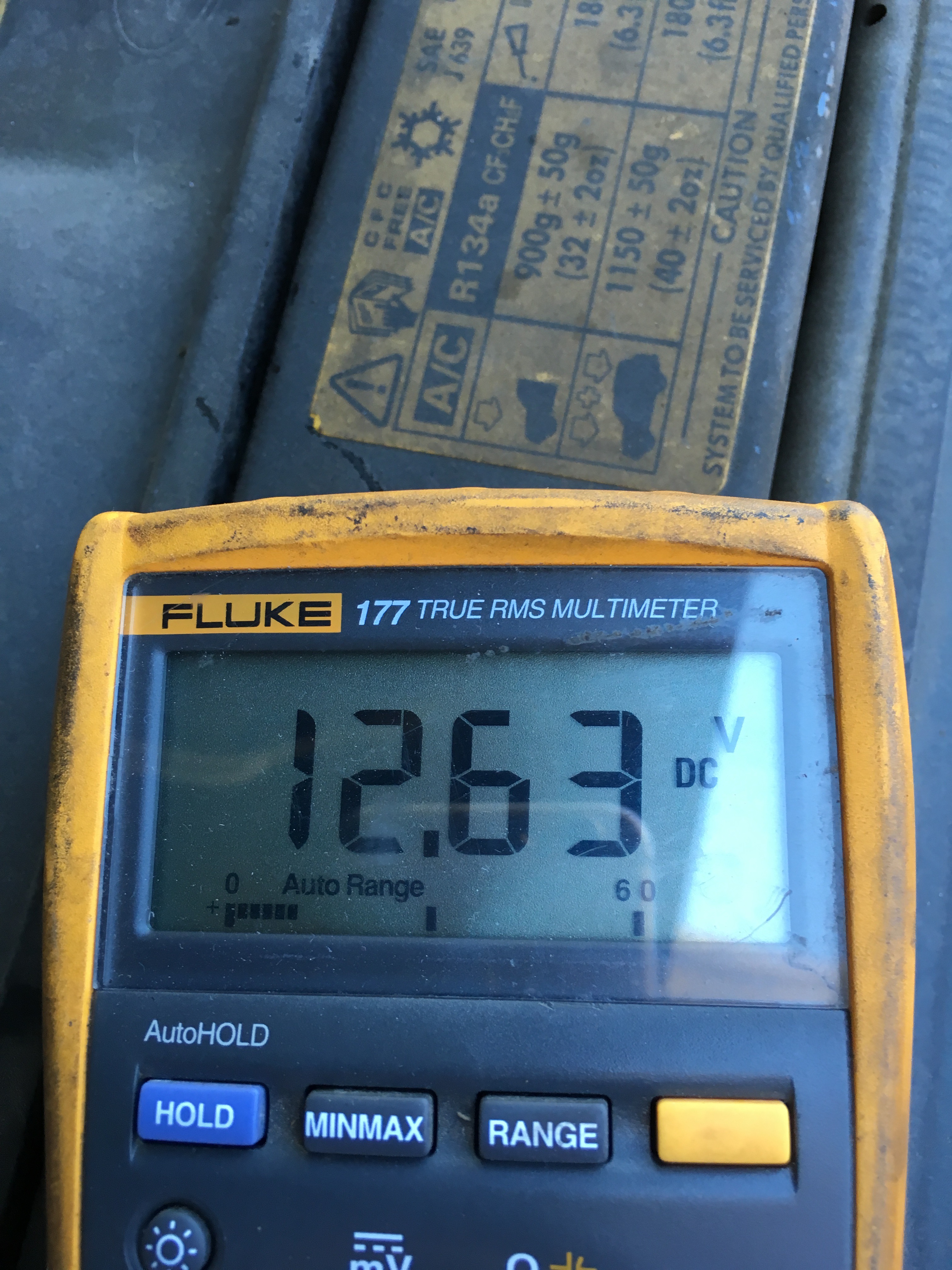

Thanks Clay99d2! The connections in the fuse box looked pretty good and I cleaned them as well. First two pictures are "before" cleaning. The third is "after". No change. Voltage at the battery is higher when the engine is not running... Hopefully you and others will have additional ideas for me to run down.
