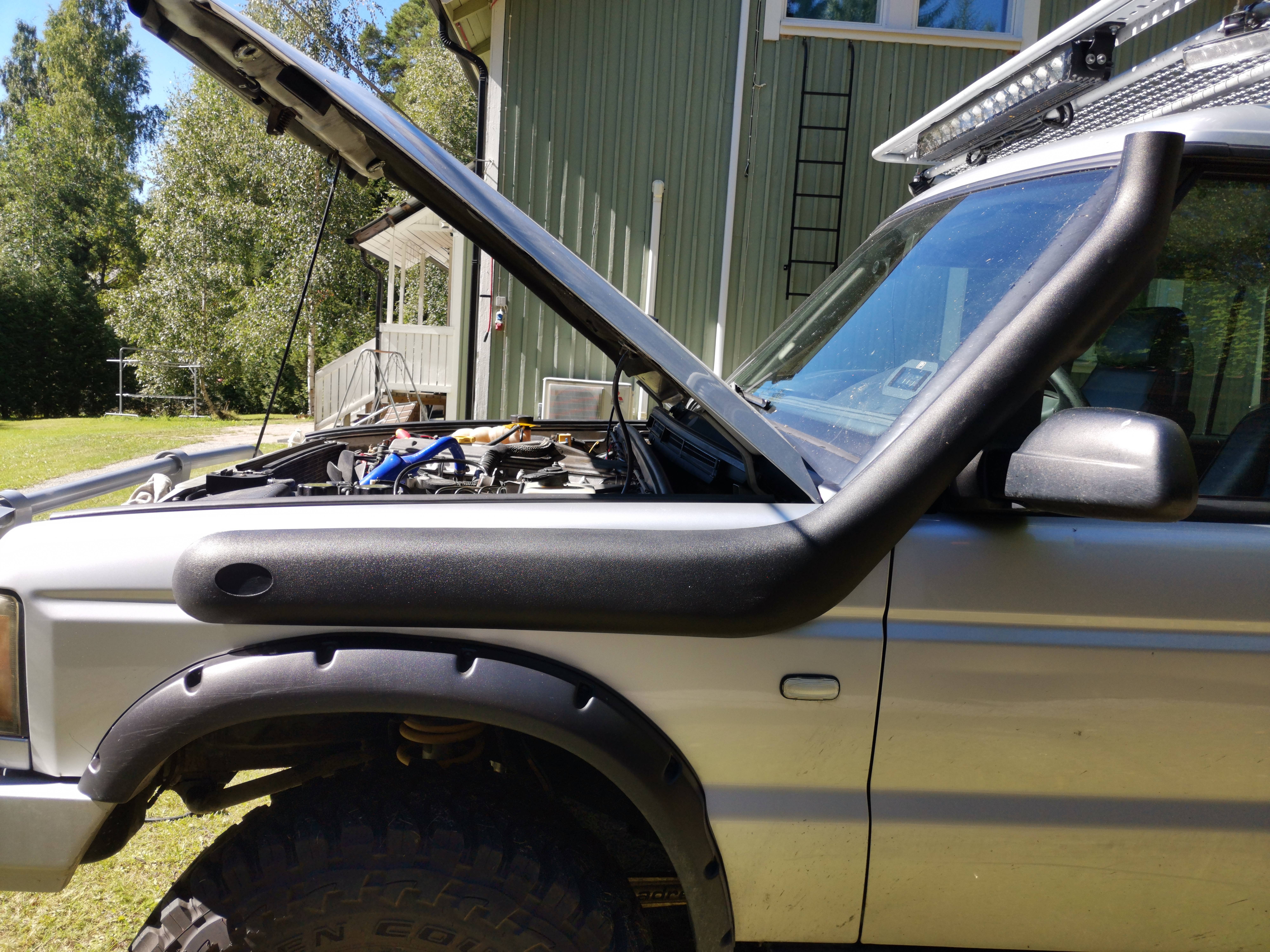

I just got a cheap chinese snorkel last week and tried installing it on the weekend, and failed due to crap quality.
It's some "Equipment addict" brand. Item SLRDC2AT.
The template is good. Made the holes according. The snorkel sits and lines up really nice to the fender but the angle is wrong so it won't line up with the A pilar. And thus it's blocking the door and not going to get it bolted to the A pilar.
You can see it in the pic
Also the instructions were a bit fubar, as the only guide for the snorkel holes is for the outer fender, and not to the inner fender.
There's some aluminiun piece, that I see is in a Terrafirma snorkel also, but zero instructions on what to do with it. And the snorkel won't fit through the inner fender original hole.

Goliath off-road has a youtube video installing a cheaper safari style and had the same problem. They took a heat gun to the corner where it ramps up and fixed it. Not sure if the heat messed up the texture or not.
