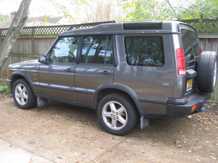

So I get up this morning at 3:45 and drove 2 hours to a small town in Arkansas where I caught a puddle jumper flight to Memphis, TN. I bought a beautiful rig who has no name at this time. I'm sure I'll come up with a good name soon. The sellers met me at the airport and I took possession of a 2001 SE7 with 137,XXX.
So I get out on the road for my six hour drive back home and the "Service Engine Soon" light comes on. Rig drove great all the way home without a single problem. I stopped by AutoZone on my way into town and got these codes:
