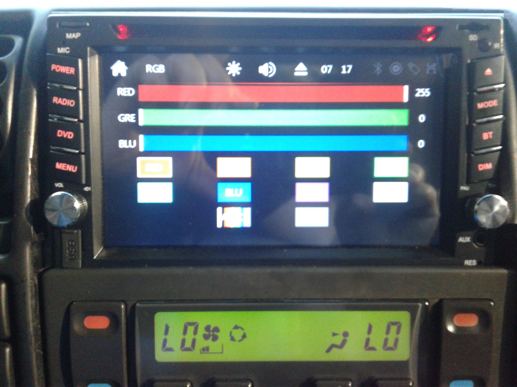

I spent $40 on a generic bluetooth DVD/GPS/rear-view camera deck on eBay.
It's fabulous. I cut the plastic of my housing so that I could go Double DIN because I wanted a large rear-view camera monitor. Discos have lousy visibility in the rear, so a rear-view camera is an enormous enhancement.
These decks let you mirror your smartphone, run apps like Spotify for music streaming, etc. There are eBay kits available that let you keep your steering wheel music controls, too.
This is a good option for hands-free cell phone calling, plus you can watch movies with your date when you go camping.
Why would I live without all of the above just to keep some ancient factory deck?
Oh, these units also have USB ports... which your factory deck doesn't have.

Do you recall the name of the $40 ebay deck you got....sounds like my speed! Was it this one https://www.ebay.com/itm/7-Inch-Doub...QAAOSw2bhdRV-f
