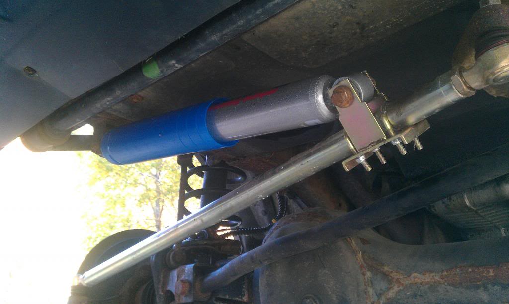

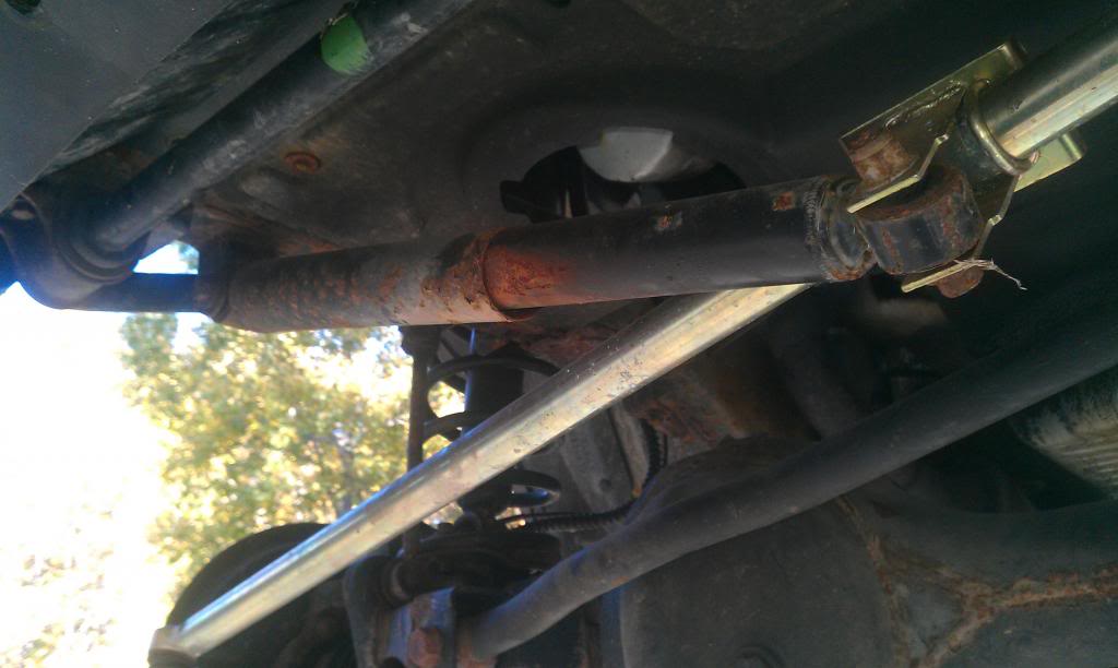

I'm not really sure about the bushings but my guess would be to examine each of them, look for cracks or any other signs that they are going. As for the steering damper, well in some cases you may notice some minor vibration while driving but in my case I just did not like how ****ty my stock damper looked so I decided that with 130K on it, now was a great time to replace it. For the tie rod ends Lift the front up on jack stands and try to wiggle the wheels, or go have a mechanic examine it. I did not realize mine were bad until I went for a state inspection, my truck failed because the tie rods were bad. Inspection stations check tie rods as standard procedure since its considered safety.
Heres what my old damper looked like:
and my new damper complete with the HD tie rod kit:
Good luck man.
