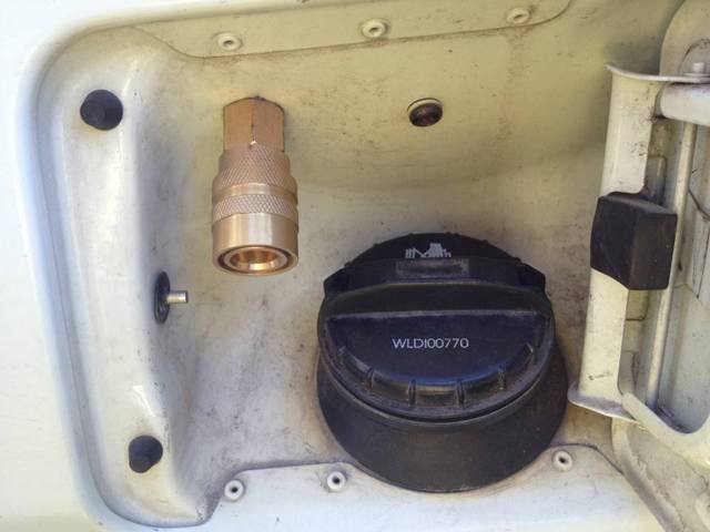

I’m interested in this as well , theoretically could I fab up a box to hold the compressor in the engine bay where the jack goes and run the lines under the truck and mount a auxiliary tank where the sls pump should be then add the air connector in the same place as this picture
