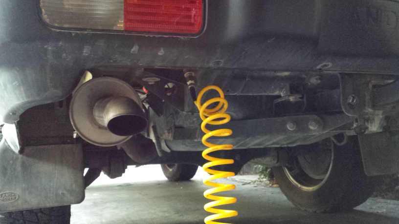

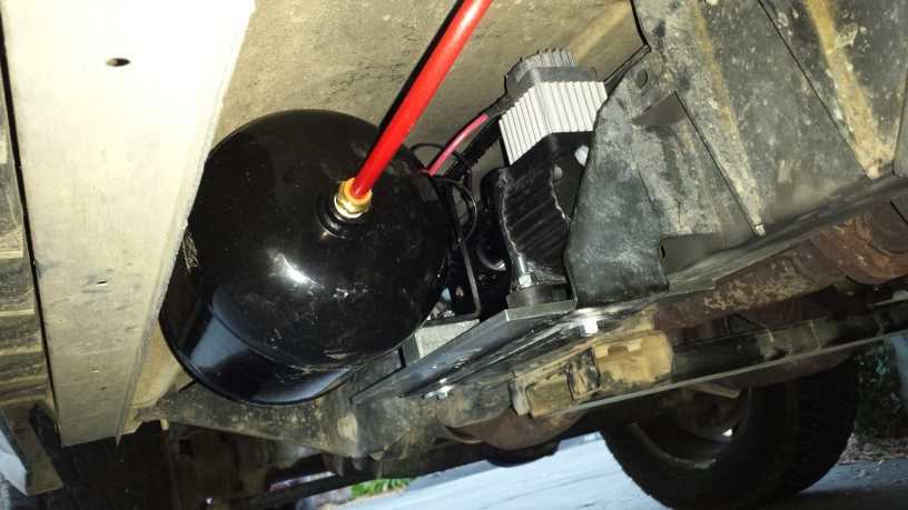

Here is what I did:

That is very cool but it wont work for me. That spot is submerged in mud every time I go offroad.

Originally Posted by Discorama
Here is what I did:
