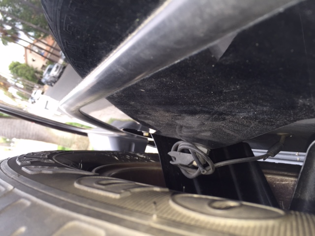

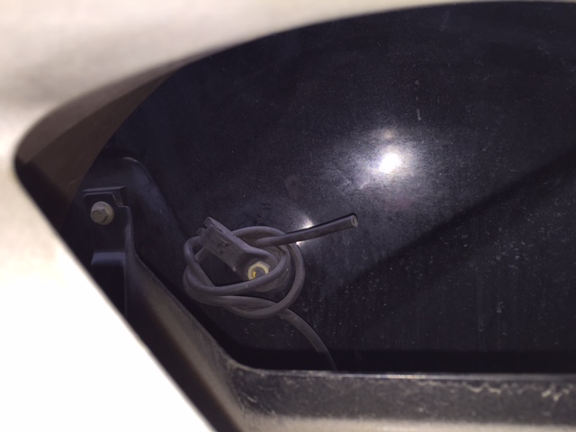

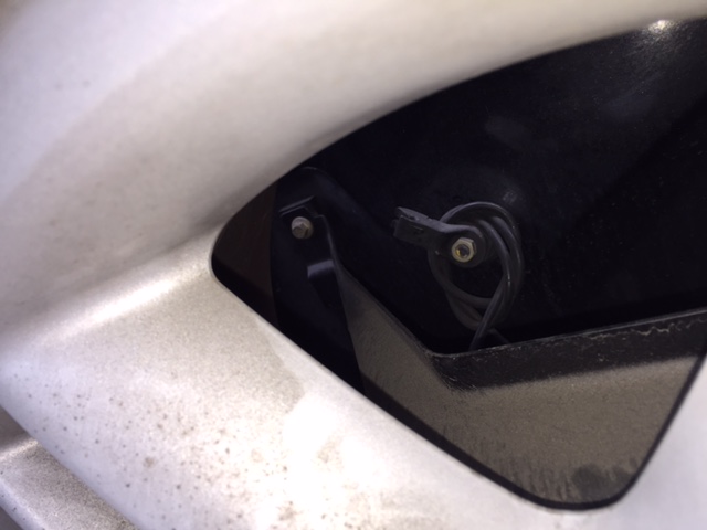

Dear D2 forum:
There is a 1/4 black rubber tube located at the back of my 2003 D2 spare tire holder. The tube comes out from inside the rear door but there nothing attached to the end of the tube. There's a black plastic part that is screwed on the door which is also located behind the spare tire carrier.
What are these two parts for? Attached are some pics I took. Thank you.
First pic is taken through the spare tire:
Second photo also taken through the spare, focused on the tip of the rubber tube:
Third pic taken from the right side of the spare tire:
I think the 3rd photo makes the most sense. Could this be window washer?
Thanks again
Al
2003 D2 SE7

That black tube is for your rear window washer that attaches to your rear wiper blade to wash your rear window.

yup; your missing the rear wiper

Hi Drowssap and GPete,
Thanks for replying to my post!
The rubber tube is wrapped around the other plastic part - is that the base which holds the wiper arm? Should the rubber tubing not be wrapped around that piece and just dangling? Is there a nozzle which attaches to the rubber tube or does the tube attach to the rear wiper?
I will also call around and maybe the dealer or AB might have the parts I am missing.
Al
