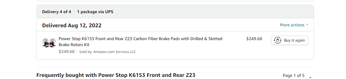

The Power Stop kit has served me well. The upgraded rotors and the upgraded pads, I think ceramic? I have used it on a couple Rovers, I think it represents a good value, might as well to do the cylinder while at it, mine rusted out and needed replacement.
If I could of found the Akebono size, I might have ordered them last time, but for the money the Powerstop have been great.
I have Akebono on the Mercedes, they are great for that. with Zimmerman rotors. I had the Powerstops, but they only lasted a year or so. 6000 lb truck driven like a sports car, so I am not surprised, but I still like the Powerstop for the Rover.
