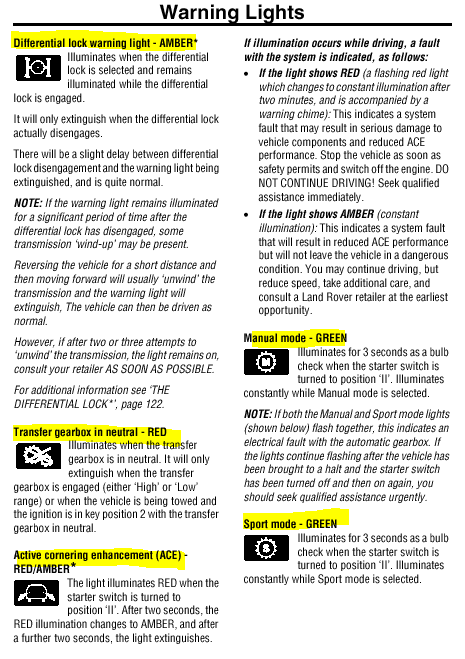

Here are all the Warning Lights & how they function. Go NUTZ!!!
It's not a matter of IF they will go on, it's just WHEN.
