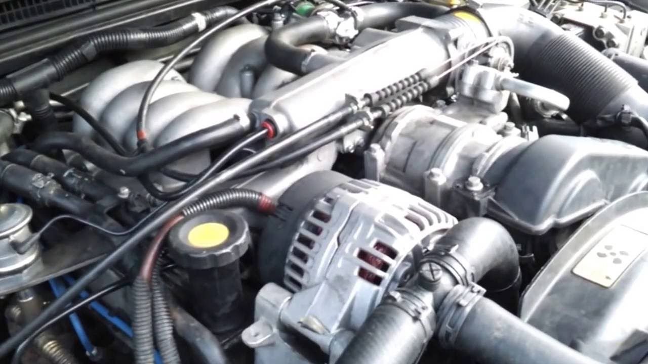

Old Mar 25, 2018 | 10:18 AM
Best4x4's Avatar
Posts: 8,009
Likes: 2,512
From: Beaumont, TX
Old Mar 25, 2018 | 10:21 AM
Best4x4's Avatar
Posts: 8,009
Likes: 2,512
From: Beaumont, TX

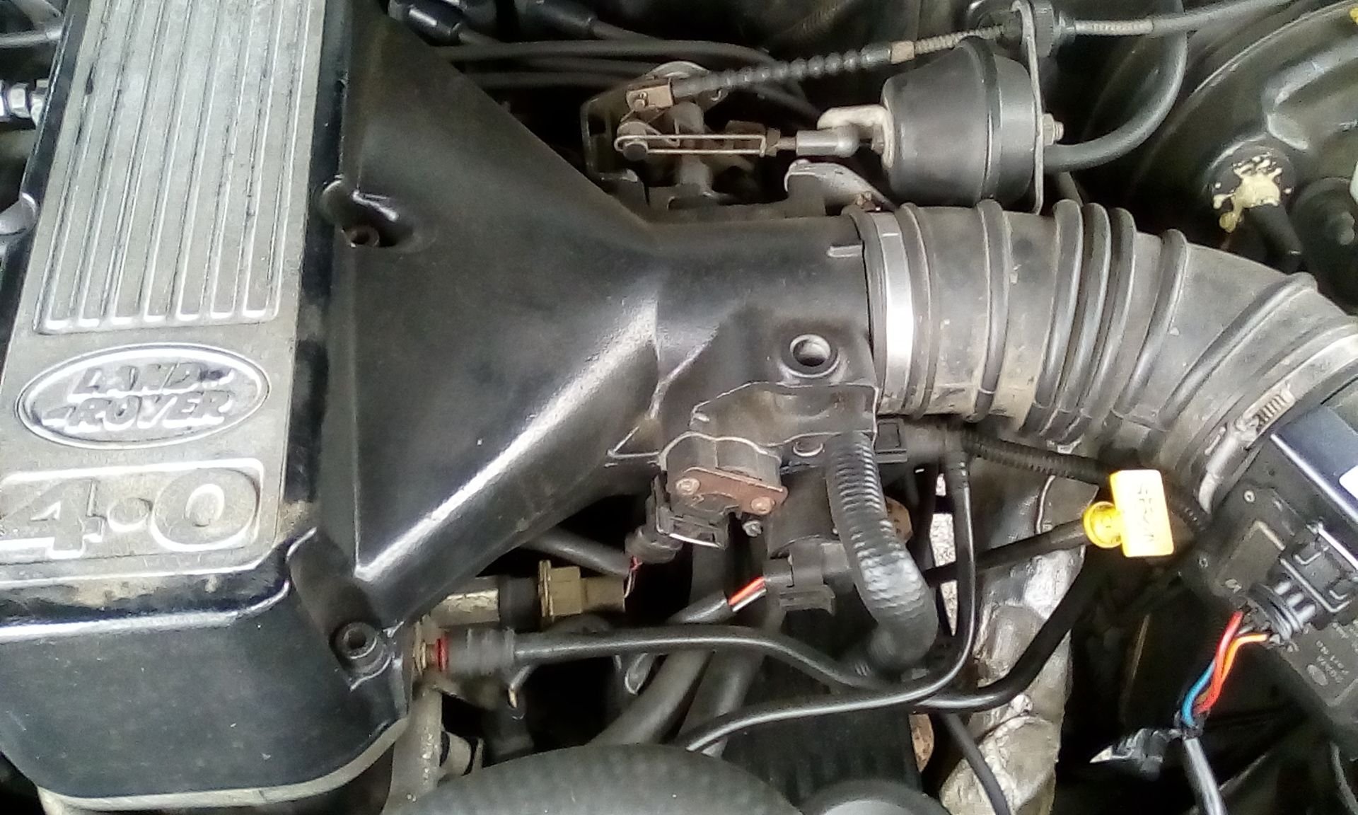

You are looking for the hard plastic line that goes into the intake manifold with the red circle push connector. It's just in front of the passenger side valve cover breather hose.
Old Mar 25, 2018 | 03:35 PM
RICKYRICARDO's Avatar
Joined: Mar 2018
Posts: 16
My 1999 land rover appears to have the brake valve located on the driver side.
