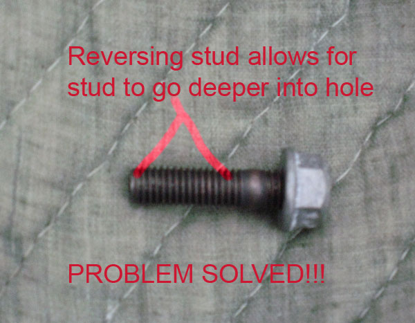

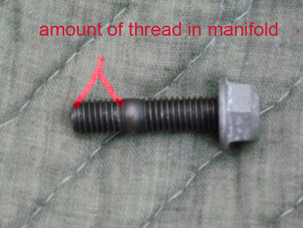

I just looked at the flange in question and found that the stud was gone and only about 1/3 of the threads in the manifold side were stripped out. I had a few extra new manifold studs and nuts laying around so I got to thinking that normally the shorter threaded section is what you screw into the hole and the longer section is what the nut attaches to. So I did a little measuring and sure enough, if I reversed the stud the longer section would screw into the remaining threads in the manifold and then the nut could be put on to cinch it tight.
I used a 8mm x 1.25 tap to clean up the rusty threads and applied a little machine oil. I put the nut on and tightened it up against the non threaded section. I got under the truck with a socket and long extenstion and tightened the sucker up! NO MORE EXHAUST LEAK!
