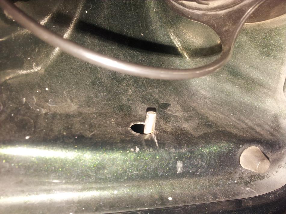

The hurricane has me stuck in the garage today and i've been trying to fix my fuel flap. My fuel door will latch shut, however it foes not latch very tight and keeps popping open when I hit a bump. I have already replaced the plastic latch but I noticed that the metal actuator pin seems rough like it has been broken off. Can anybody show me some pics of theirs so I cqn compare it to mine.

I hope this is what you were looking for.

Here are photos of mine. Showing how far it protrudes, and the plastic washer, and the plastic catch on the door. PS: Those plastic catches are notorious for breaking, or being out of adjustment.
EDIT: OOPS! I was adding photos with my post open, so didn't see the previous post till mine was up. But gives a different perspective.

Thanks for the photos. It looks like my actuator is fine. I figured out the problem. I can get it to latch if i pust up on the flap slightly while closing it. somtimes its the simple things haha

when I bought my DII, the metal tab that holds that plastic needed to be bent up slightly for it latched correctly. Try aligning the pin and slot and see if that helps.
Maybe up, down, or in/out. Just be careful to not break it.
