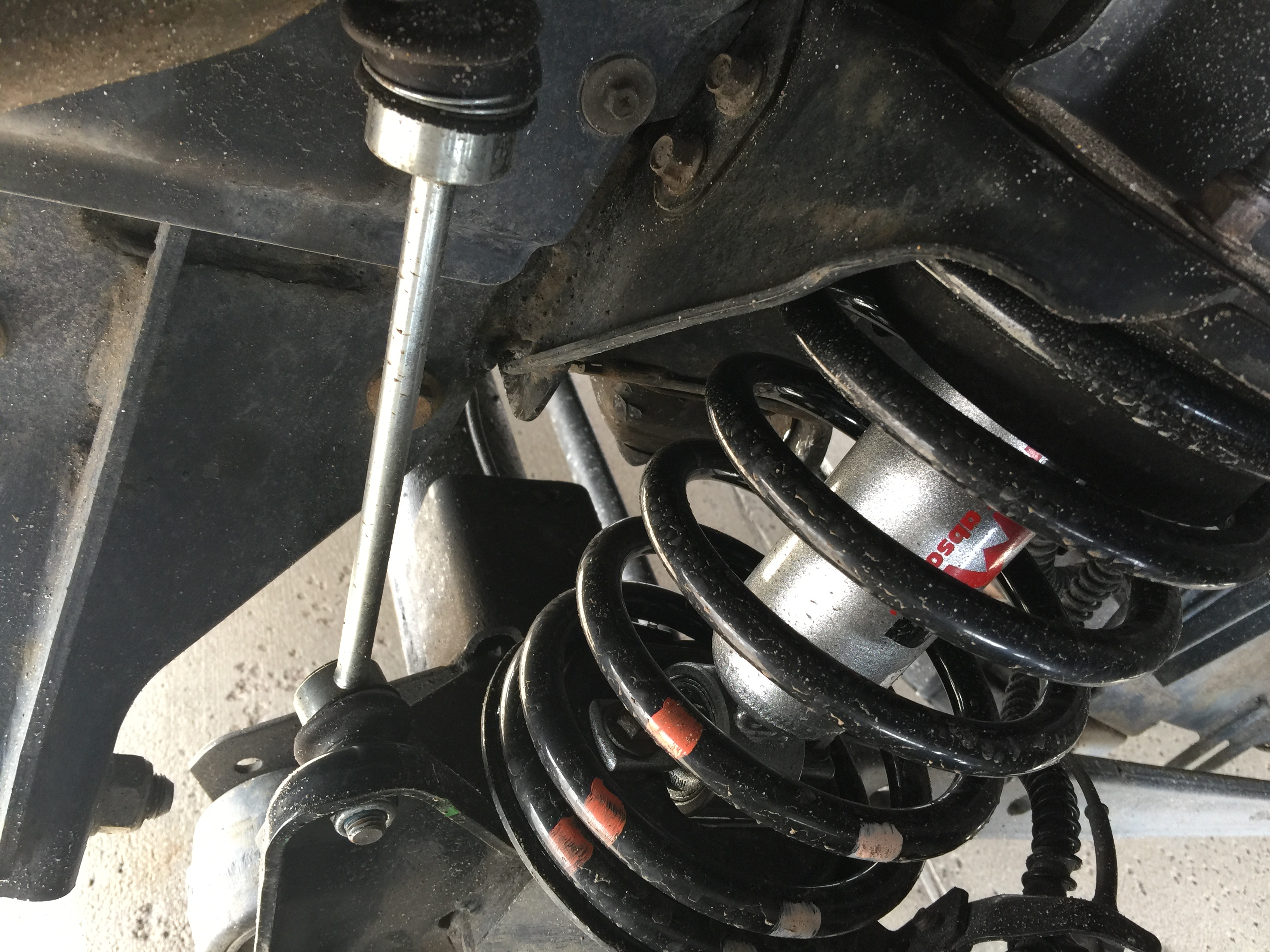

Just did my front shocks and springs. Replaced the sway bar links as well.
I did not want any lift and still use the truck in town as a daily driver. I used Lucky8 for my parts
2 stock front springs, 2 TerraFirma front shocks and 2 new Allmakes sway bar linkages. Shipped was $234.
It took me the afternoon to replace all the parts. Using the bottleneck on the bump stop base the old springs basically slipped right out. Needed a little spring compression on the new spring. (Remember it was a stock height replacement)
The Atlantic British how to video was a great resource.
Well spent $234. Love it when you can feel the difference when driving.
My truck has 145,000 and air shocks I n the rear. I am going to order some rear shocks and sway linkage for the rear this week.
